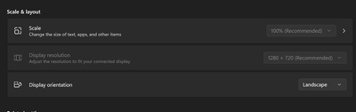

Hello @Jocelyn_Intel ,
As i said earlier my USB-C port is 3.1 Gen and i don't think it gonna support video output but still i tried and it's not working.
Also when i connect using HDMI-HDMI i'm unable to change display resolution (it's grayed out) but when i connected to other monitors i was able to get 3440x1440 resolution.
1. Maximum resolution is 1280 x 720
2. It's grayed out, i cant edit any of the options.
3. Yes, the drivers are upto date.
Im not sure what's the exact problem here but if i can attain 3440 i will be really happy.

Hello, @Madhav_M
Thank you for your time.
Doing the calculation bandwidth for 3440x1440 @100Hz, it requires a bandwidth of 14.86 Gbps and based on the Asus website technical specifications for X409FA, this laptop has a 1.4 HDMI port which won't allow such bandwidth required to display this resolution @100Hz.
The maximum effective bandwidth for HDMI 1.4 is 8.16 Gbps, please check How to Use Bandwidth to Determine the Best Video Output, so the output you should be getting is around 30Hz to 50Hz, because 60Hz requires 8.92 Gbps.
Considering another display works well and only issues are present on this display, we recommend you check with your System Manufacturer why the display is locked to this resolution since the Intel Graphics Command Center detects all resolutions and drivers work fine as other displays work normally.
