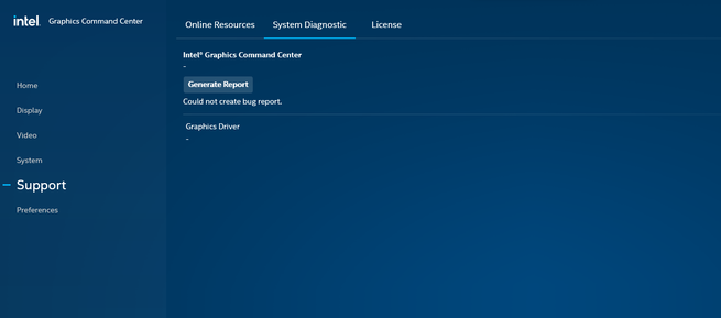

Attached is the system log file SSU. The second option did not generate anything. I have tried using HDMI-to-HDMI connection at a maximum of 120Hz, but I cannot use DP-to-DP because my laptop does not have a DP port.

Here after uninstall intel arc
