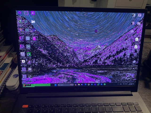

I just downloaded and installed Intel corporation Display 32.0.101.5990 now and suddenly my display looks like this picture below. I don’t know what to do. I shut down and start my laptop so many times but it is the same i also restart it but nothings changed
I got the same problem. I can suggest a solution which worked for me.
Go to Device Manager > Display adapters > Intel(R)... > Driver > Roll Back Driver.
Hope that works.
