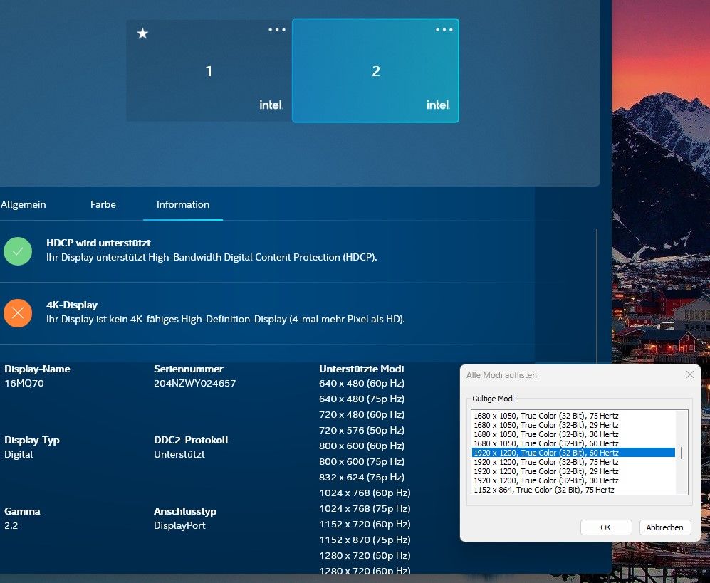

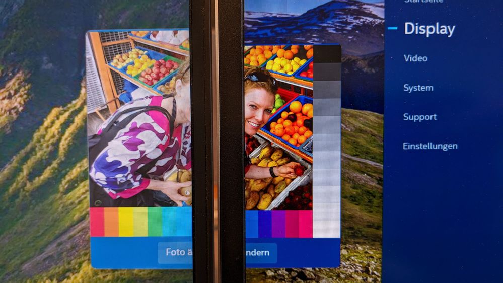

My LG gram display looks like it has a fog-filter over it.
The second LG 16MQ70 Display next to it looks right.
I have the latest Version 31.0.101.4146 installed.
During installation, the colors are for a short time right.
LG gram 17'' (2022)                                                  LG 16MQ70

This looks like HDR is turned on at the source (the graphics solution) but not at the monitor.

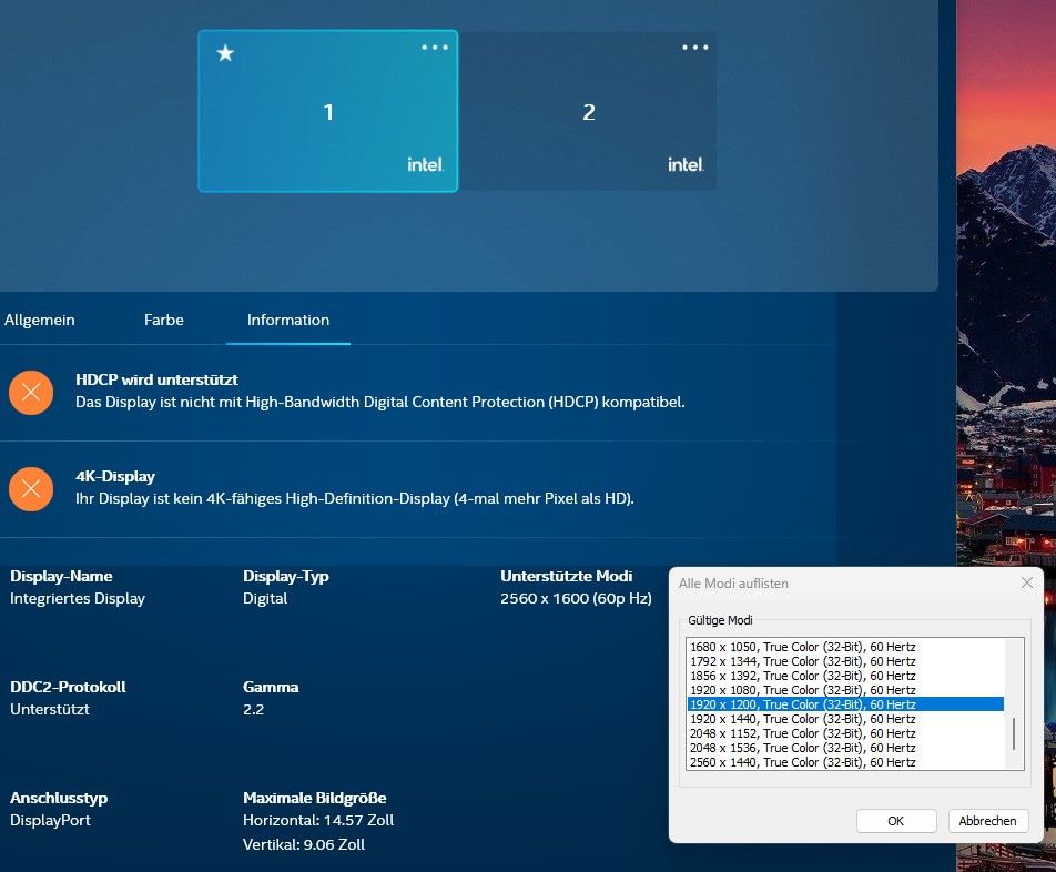

Hello Deivid,
1.  My LG gram has a 12th Generation Intel Core i7 - 1260P
2. They looked the same a couple of weeks ago. After an update the color changed and I set up different brightness for colors under the Intel Grafik Controlcenter (something under 10) and lifted up the brightness off the laptop. Now two days ago I had several updates for the grafikdriver. One of these updates made the screen real dark and I set the brightness in the Intel Controllcenter back to 38 and it lookednormal. Then with the next update the display looked like on the pictue above.
3. It's a LG gram 17'' (2022); Modell17Z90Q-G.AA79G
The second display is a 16-Zoll +view für LG gram Portable Monitor mit USB Typ-C; Modell16MQ70.ASDWU
4. It's a laptop-display, so I can't test it in a different way
5. The color changing occured after updating the driver
6. The first display is the laptop-display, the second display is connected via USB-C Thunderbold

Nordlicht
6,511 Views
1. HDR was/is disabled.
2. It Laptop, so no
3. Yes, but today there was a display update in the background  (30.0.101.1109) and the display went black and came up with the right colors again.
4. After the Windows update I uninstalled the intel driver stuff and run the LG Update (30.0.101.1369) and i still got the right colors.
5. So I stay without the Intel generic driver suff
