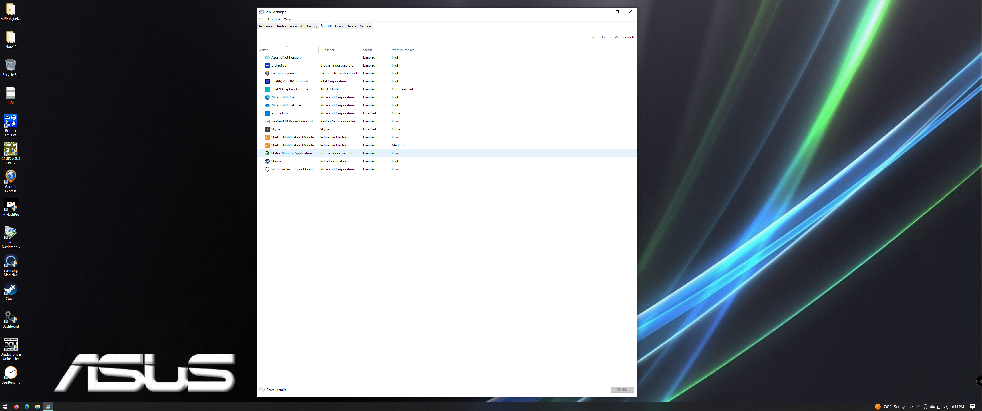

DeanL
8,626 Views
Startup & current running non-Microsoft processes (as of 2 mins into desktop)
Hugo_Intel
8,513 Views
Hello DeanL
Thank you for sharing the screenshots. I don't see any service that might cause issues with Arc Control and from what I see the Arc Control process is running in the background so it is strange the UI does no come up. Allow me to check this with our team and will post back once I have the next steps for you.
