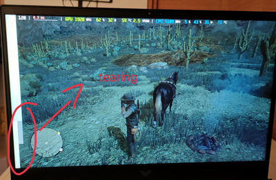

  2. tearing happens in all games—dx9-dx12 or vulkan. vrr works fine but doesn’t stop tearing. rtss is on so you can easily spot it
  3. tried every oem driver (intel & nvidia), old and new. also ran every driver i could grab from intel’s site, but same result. thought it might be windows-related so repeated all steps on windows 10—still same. used ddu for a clean uninstall/install each time.
  4. i’d share screenshots of my in-game settings but it’s all in turkish, so here’s a quick rundown for rdr1:
  • vsync off (if i turn it on, it behaves like vrr is disabled)
  • triple buffering off (on/off made no diff)
  • everything set to ultra, dlss and frame generation on, reflex on+boost. tearing’s a bit less with frame generation off, but i don’t wanna play without it.

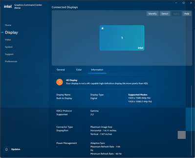

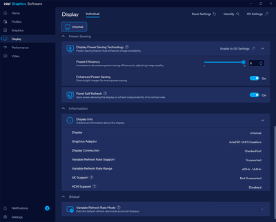

  1. i’m not using an external monitor. vrr’s enabled in both windows settings and intel graphics software, running at 144 hz.

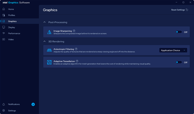

if intel graphics software had any vsync options it might help, but there are almost no settings. intel graphics command center (beta) has smart vsync which kind of helps, but doesn’t fully fix it. i’ve seen people mention tons of vsync settings in intel graphics software—if there’s a way to get those, let’s do it.

My laptop screen does not support G-Sync or FreeSync. For this reason, if I configure my BIOS to only enable the Nvidia GPU, I lose the VRR feature. VRR only works on my device when only the iGPU is active.

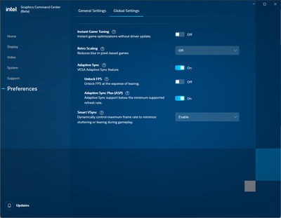

in the intel graphics command center (beta), there's a setting called "smart vsync." when i enable it, screen tearing doesn’t happen if the game runs at a fixed fps. but the moment fps fluctuates, even by 1 frame, the tearing comes back. and this happens across the whole game. VRR is working fine, but the tearing still shows up.
apparently, when vsync is enabled on a driver level, all the tearing disappears. but there’s no option to enable proper vsync in the intel graphics command center or any other intel app — there’s only “smart vsync,” and like i said, it only works when fps is locked.
again, screen tearing is present in all games, regardless of the game’s settings. if i enable options like dlss fg or fsr fg, the tearing becomes even more noticeable.
in my opinion, the solution is simple: intel should add a full driver-level vsync toggle to one of their graphics apps. most intel gpus have this, but i don’t understand why mine doesn’t.
in some games, like cyberpunk 2077 or league of legends, enabling vsync from in-game settings eliminates tearing, and vsync works well with VRR. but turning on in-game vsync has a big downside: i can’t use frame generation with it, because they’re not compatible. that’s why i need a proper driver-level vsync solution.
