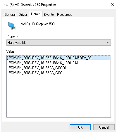

I just installed the latest beta driver released on 4/29.
Looks like there is slight improvement, but not fully fixed.
As shown in youtube video link # 2 in first post, previously, the 2 external monitors would just flicker if the usb-c hdmi adapter is connected before the built-in hdmi port, and neither monitor would display anything.
Now with the new beta driver, the usb-c hdmi monitor connected first will display a picture, but the 2nd external monitor connected subsequently to the built-in hdmi port will not light up. The 2nd external monitor remains off in sleep mode,
in fact, shows a "No hdmi signal" message on the screen before going to sleep.
However, both Windows 10 Display Settings and Intel Graphics Control panel show all 3 displays as if they are active. (see attached)
One good thing now is that triple display detection does not cause a computer blinking spasm.
As before, with this newest beta driver, triple display still works successfully if the two external monitors are plugged in this order.....
1) built-in hdmi port
2) usb-c hdmi adapter.
