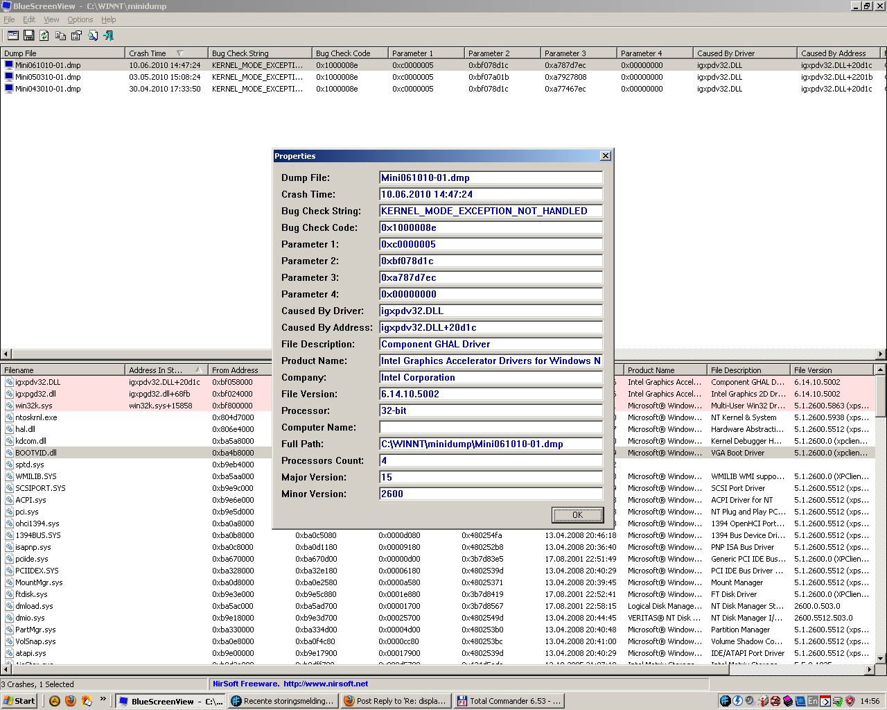

This error happens permanently when i connect to desktop from other remote one via Remote Desktop Connection.
Both machines are winxp+sp3 with all latest updates. Server one has novell auth integrated.
Config of server:
display : Intel(R) Q965/Q963 Express Chipset Family
display driver version: 6.14.10.5016
motherboard: Intel Guardfish DQ965GF

Have you tried with a previous version?
http://downloadcenter.intel.com/Detail_Desc.aspx?agr=Y&DwnldID=17115&lang=eng http://downloadcenter.intel.com/Detail_Desc.aspx?agr=Y&DwnldID=17115&lang=eng

I've tried all prev version too but still expierenced with troubles.
You can my snapshot from BlueScreenView. Because error happens from time to time only i think it's just troubles in LAN do not handled well
