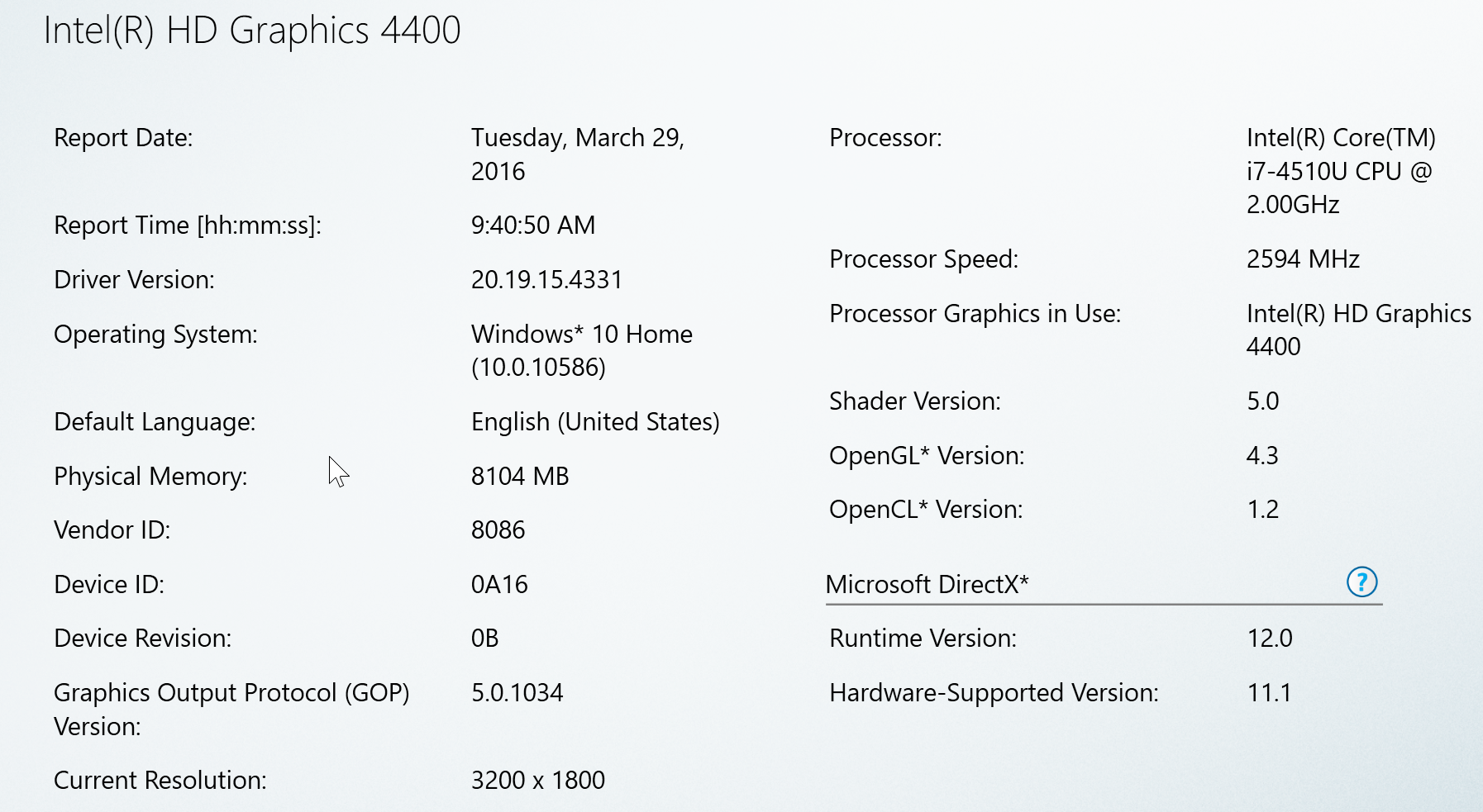

hi, i hope someone can set me straight, i am confused. i have a lenovo yoga 2 pro with the Intel HD graphics 4400 chipset. In installed a fresh copy of windows 10 and i am looking for current intel video drivers. the drivers that i am currently using seem to be much newer than what is listed on the intel driver web site....why? The driver is listed as an Intel driver in device manager....

Actually, the Intel driver that you can download from the Intel website is a newer version, what it counts are the last 4 digits which is the build number.
Please see http://www.intel.com/content/www/us/en/support/graphics-drivers/000005654.html Understanding The Intel® Graphics Driver Version Number
You can download the driver here:
https://downloadcenter.intel.com/download/25860/Intel-Graphics-Driver-for-Windows-10-15-40-4th-Gen-?product=81497 https://downloadcenter.intel.com/download/25860/Intel-Graphics-Driver-for-Windows-10-15-40-4th-Gen-?product=81497

Ivan, that helps a lot, thanks for the info!
