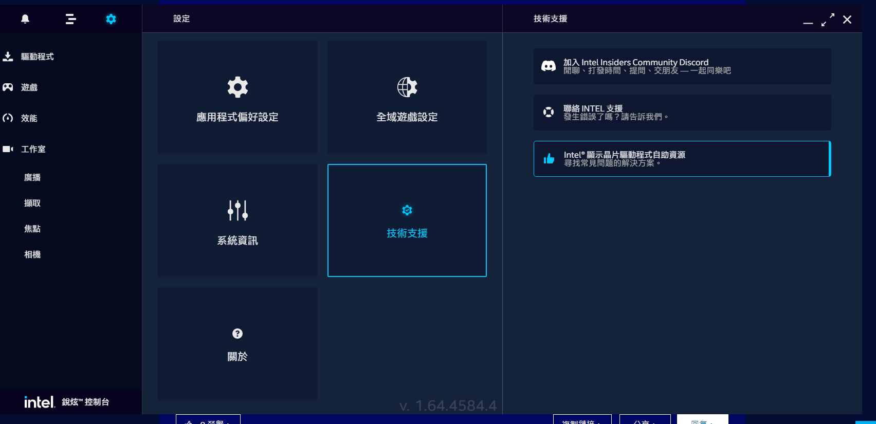

- Tried creating the Intel® Graphics Command Center report following these steps:
- Open the Intel Graphics Command Center
- Navigate to the Support tab
- Select System Diagnostic
- Click Generate Report
- Select Save and name the output file.

4.在ARC 控制台沒有找到以下(如圖):
