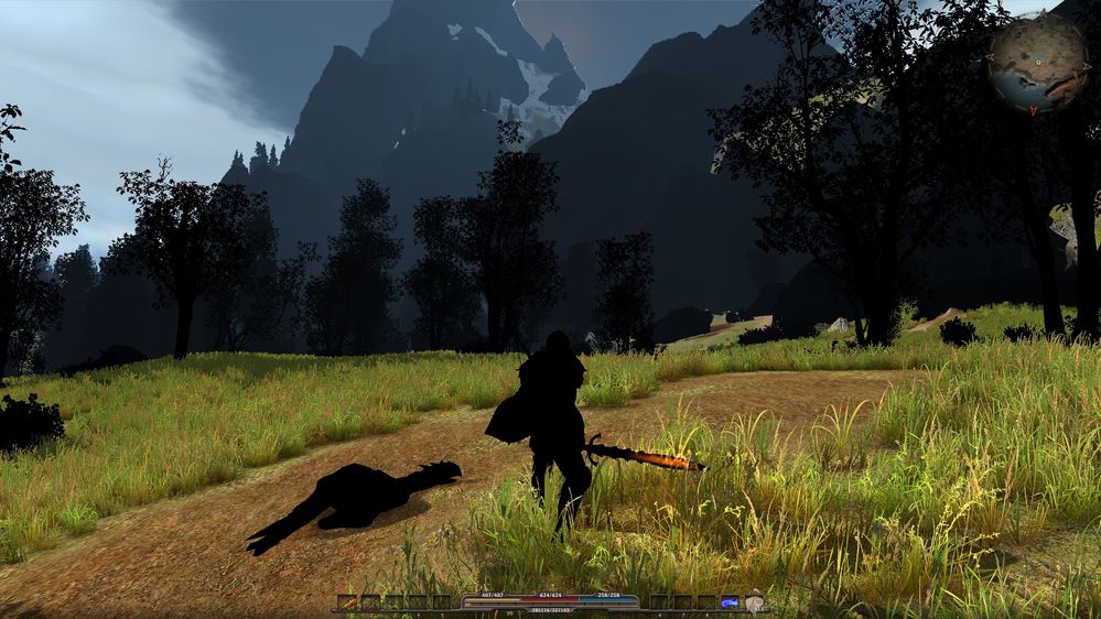

It's just the Intel d3d9 driver of ARC GPUs, with DXVK there's no problem.
Please fix (I know it's an old game that nobody loves but until now it's the only game having this kind of issue with ARC drivers :D)
ARC Driver: lastest beta (5444)
Steam version of Arcania / Arcania - Fall of Setarrif (NO legacy version, the "actual" one)
Just launch the game, problem is there (black surfaces), no matter the settings (but if you want optimize some performance, please go on!)

hi @hekoone have you try using old driver d3d9? Could be the game itself not support the latest script/update.
Just what i thought
No, but forcing the "very old" driver behaviour (->d3d9to12) with this: https://github.com/narzoul/ForceD3D9On12 partially solves the problem but some black surfaces remain (and the game crashes to desktop). With DXVK the surfaces are correctly lit.

Of course I cleaned up the D3D shader cache of Windows AND Intel drivers *AND* manually the driver store
It's just the game being an expected corner case (as Gothic 3 that crashes loading a savegame), all other tested games works well.

"difficulties you are having that are preventing you from running this game on DXVK, which is known to rectify the issue."
NONE, just to have a native *Intel* d3d9 driver working in every circumstance.
To be more precise, with DXVK there are some foliage artifacts, but there are more solutions (dgVoodoo2) to run the game with no issue.
Another example: Syndicate from EA crashes after some seconds in game (not in the menus, in the game) and DXVK solves the problem. But a native solution would be more future (past?) proof.
Of course these are old games, so no need to fix them in near future, I'm just reporting the behaviour of the d3d9 driver!
Update (maybe interesting for the devs): it's a bug specific to the ARC GPUs+their D3D9 driver, I did just try with an Intel i5 11600 iGPU (Xe-based too, same driver package of the A380) and there's no bug.
Same behaviour (old Intel GPUs -> no bug / new Intel GPUs -> bug *with the same driver package*) in other games (in Halo Custom Edition the pistol zoom has a problem with the alpha channel and the layer used for the scope of the pistol, problem that is NOT present just using the iGPU)
