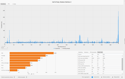

I'm reaching out because I'm having some serious performance issues with my Intel Arc A770 while playing Call of Duty: Warzone Resurgence at 1440p.
Even with the lowest graphics settings at both 1080p and 1440p. At 1080p the frame rates are way below what I expected, making the game less enjoyable then on GPUs of the competition.
What’s really disappointing is that using Intel XeSS, especially in Ultra Quality mode at 1440p, only gives me a slight boost in performance but still performing worse than native 1080p. I was really hoping this tech would make a bigger difference.
I've already updated all the usual drivers and tried various in-game settings, but nothing seems to work. I would really appreciate your help in resolving this issue.
It would be super helpful if you could answer a few questions for me: Are there any known issues with the Intel Arc A770 and Warzone (Resurgence) that are currently being looked into?
Is there a timeline for new driver releases aimed specifically at improving Arc graphics cards for Warzone or Call of Duty (Resurgence)?

1) I've got the game installed on both Battle.net and Steam, and honestly, the performance feels identical. I have read that there can be differences between both Launchers, but for me the performance is exactly the same.
2) This issue really stands out in Warzone and Warzone Resurgence. Regardless of the settings or CPU, my Arc A770 just doesn't stack up against the competition in this mode.
3) Rebar is definitely turned on.
4) I'll share some screenshots of my in-game settings.
5) I just updated the driver to the latest version. You can check it out in my ".ssu" file.
6) I've uploaded the CapFrameX data from three runs. The first two were at 1440p with XeSS Ultra Quality on, and the third was native 1440p. Everything else is the same as in the screenshot I shared; the only difference is the Upscaler.
7) When I say there are serious performance issues, I mean the AVG FPS and 1% and 0.1% lows are really poor in the latest Call of Duty titles even at the lowest settings. Warzone, MW3 (2023) and Black Ops 6 (latest beta) are particularly rough on Intel Arc dGPUs. MW2 (2022) didn’t have these problems, and the XeSS implementation was way better back then. I have a Ryzen 7 5700X3D, and usually, with competitor GPUs, the X3D boosts the Average FPS and low 1% and 0.1% at both 1080p and 1440p resolutions. But with Intel Arc, the issues persist regardless of resolution or settings. You can really feel the difference in Warzone Resurgence.

I was just messing around with some settings and I think I’ve figured out how to boost the performance for Intel Arc. I managed to get around 90-120 FPS in Area 99 at 2560x1440 using XeSS Ultra Quality Plus. I’ve attached a screenshot too. I posted this right after testing it out, so I still need to keep an eye on the performance.
You need to do the following things:
Open your File Explorer and go to Documents -> Call Of Duty -> players -> s.1.0.cod24.
Once you're in that file, hit "CTRL + F" to find each column in the text document and replace it with my settings.
FIRST 1:
// Select water caustics mode
WaterCausticsMode@0;41499;11445 = Off // one of Off, Low Quality, High Quality
SECOND 2:
// Enables persistent static geometry wetness from water waves.
WaterWaveWetness@0;57752;20945 = false
THIRD 3:
// Select weather grid volumes quality
WeatherGridVolumesQuality@0;38459;58629 = Off // one of Off, Low, Medium, High, Ultra
Almost done! Just need to tweak this setting:
// Thread count for handling the job queue
RendererWorkerCount@0;51989;59387 = 15 // -1 to 16
Important note! When you're configuring this, remember to input the number of threads in your system minus one. This will ensure your system runs smoothly with these settings! If you're using an AMD processor, you can easily find the info by Googling your CPU and its thread count, then just subtract one. For Intel users, I’m not quite sure how it goes, so you might have to play around with it.
Finally, you can configure XeSS either in the text document or directly in the game.
// XeSS quality
XeSSQuality@0;27441;8284 = Ultra Quality Plus // one of Ultra Performance, Maximum Performance, Balanced, Maximum Quality, Ultra Quality, Ultra Quality Plus, Native Resolution
I hope I was able to help you all! I've definitely noticed a boost in my performance. Here's a screenshot for you and the "s.1.0.cod24.txt" file.

No, you don’t have to overclock your GPU. This is just a solution for the performance problems in Warzone 4. If you feel like overclocking, go ahead and tweak your card as long as it stays stable.
This guide is specifically for fixing Intel Arc Cards performance in Warzone (and possibly BO6).
It worked for me and I´m playing now with 120 to 150FPS in Warzone Area99 with XeSS Ultra Quality Plus at 1080p.
