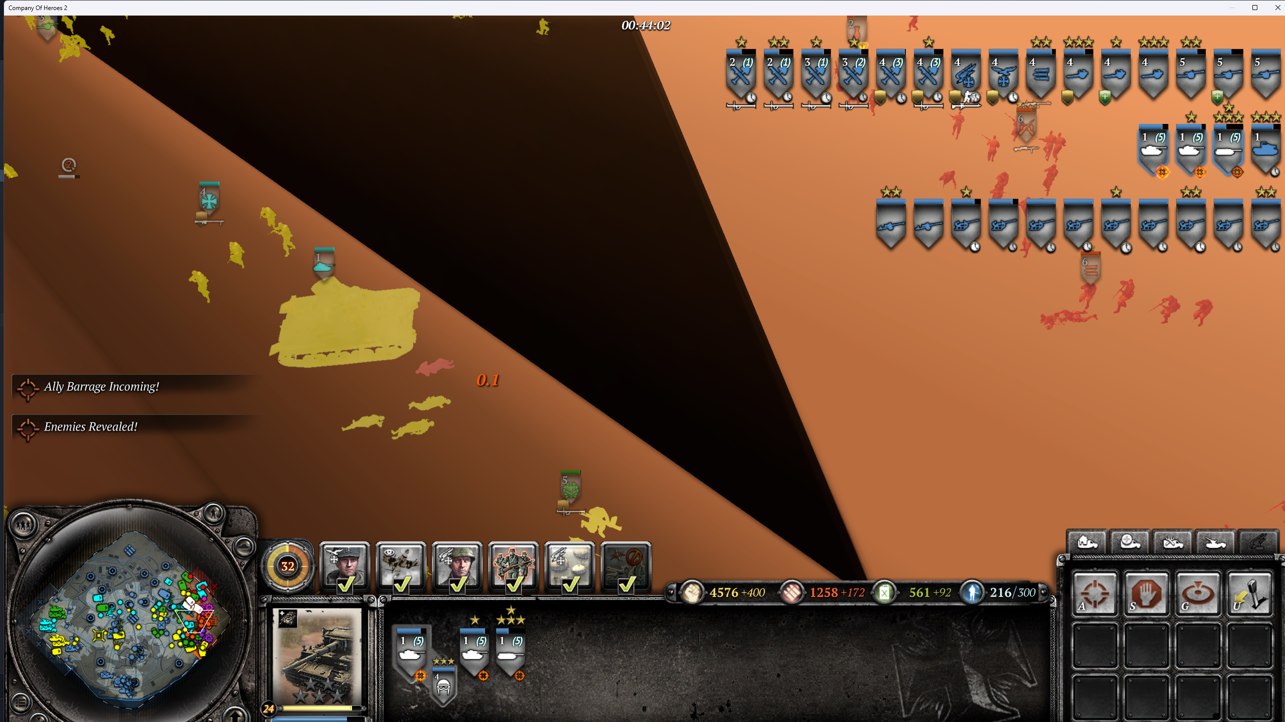

Dear Intel Arc support team!
When i'm playing Company of Heroes 2, after 15-30 minutes, the textures stretch on random parts of the map. Several Arc users reported this months ago, and looks like its still not fixed. I would like to ask the support to investigate this issue, and try to help us Company of Heroes 2 players to fix this, because this is really annoying.
Since people already reported this issue earlier, i'm going to link that post: https://community.intel.com/t5/Intel-ARC-Graphics/Game-objects-stretch-and-cover-the-whole-screen-using-Arc-B580/m-p/1692339
I have exactly the same issue, i have the newest drivers, tried different graphics settings, nothing helped, i'm sure its a software side problem.
I'll attach the SSU, and a picture of the problem. As the other Arc users who suffer from this graphics bug, i tried all the troubleshoot methods, for example lowering graphics settings, updating bios, updating graphics driver, lowering FPS, basically everything that might have helped, but the bug still occurs after 15-30 minutes.
Please help us Arc users, who would like to play this old, but amazing game!

Little update:
Now i played 4 matches. In one of them, i managed to get to 41 minutes before the graphics glitch started happening. Keep in mind that this was happening only at one side of the map, while when i looked at the otherside, everything was okey.
I noticed that if i press alt+tab, that might help to reduce the glitch, but it won't fix it permamently, only temporiraly, and only at some parts on the map. I attached a picture about this too.
Hi NagyAkos512,
Thank you for posting in our Community and for providing detailed information regarding the graphics issue in Company of Heroes 2 and for including the SSU report and screenshots. To help us replicate and analyze the problem more accurately, could you please provide a few additional details:
- Are you running the game in fullscreen, borderless windowed, or windowed mode?
- Are any background applications, overlays, or recording software running while you play?
- Does the issue occur on all maps or only specific ones? If specific, which maps have you noticed it on?
- Could you provide a short video capturing the glitch in real-time, if possible? This will help our engineering team observe the behavior in motion.
- Have you tried any graphics API settings within the game (DirectX 11/12, Vulkan, etc.), and does switching these affect the occurrence of the issue?
For FPS and performance issues, I kindly request that you provide CapFrameX data for this game. This will help us analyze performance metrics more thoroughly and identify any issues. However, please share a CapFrameX file that captures at least 2-5 minutes of gameplay.

Hey VonM!
Of course, i'll provide you with whatever you need, in order to fix this issue. We'll solve this together!
1. I tried to run the game in fullscreen mode, which didn't help, also tried windowed mode + alt tab which made it even worse at some point theres nothing visible left on the map.
2. I'm not running any background applications, i have steam overlay and discord overlay disabled, and i'm not recording.
3. I tried on 4 maps, the issue happened on all 4 of them. At somepoint even right after the start, 7 minutes later, the next game after 30 minutes, so its pretty random but its always happening. I tried Budapest map and Lorch assault mostly, both of them had this issue after a certain amount of time.
4. I attached a video, and i'm sorry for the video quality, i tried to set up the OBS as much as i can, i think the footage is clearly showing the issue now. I also attach the CapFrameX file too. The video footage shows i have like 10 fps, but thats just the recording, i don't have any performance problems.
5. Yes i even tried to implement DXVK to the game, which changes the Dx11 API to VULKAN, and sadly this didn't help either.
If you need any more details please tell me, i would like to really help you to fix this problem, because i would like to play with my friends, but now it seems impossible.

Little update:
I removed DXVK, and tried to look into the game's config files. I found out that the shadervalue was 0, and the modelquality was 0, and the terraindetail was -599 (very strange), I changed the shader value to 2, the modelquality to 2, and the terraindetail to 1 in the config file. Also lowered the texture detail to 3, and the physics to 1. and turned off AA.This MIGHT helped, because i ran 2 games, one on the same map, Lorch Assault for 1 hour, and i found no graphics artifacts. Also ran another match on a completely different map for an hour, found no artifacts with these settings. If you want, i can attach my configfile, which MIGHT solved this issue.
Now my game looks really bad, but atleast it looks like the artifacts are gone, but still don't take it as solved, because i need to further test this. May i ask you to try the game with max settings? I think thats the settings when these artifacts appear. This card should comfortably handle the game.
I suspect VRAM and shader cache related corruption.
If you need further details, i'm here to help, and thank you very much for your help!
We'll solve this together 100%.
Ákos
Hello NagyAkos512,
Thank you so much for the detailed updates, video, and config findings. Your effort in testing different settings is a huge help, and it’s great to hear the adjustments may have reduced the artifacts. Your insights on VRAM and shader cache are very valuable and will be shared for further review. I will need to conduct additional research on this issue and post an update in this thread once I have more information. In the meantime, please continue testing with your adjusted configuration, and if the issue reappears, especially under maximum settings, feel free to share the updated details and config file with us. Every bit of information brings us one step closer to a permanent resolution.
I empathize with your situation and the issue you are facing. However, I kindly request that you create a new thread for your case. This will allow us to focus on your specific problem and provide you with better assistance.

Hey VonM!
Thank you very much for your assistance! Something still doesn't really feel right even after changing these settings i mentioned above.
On the otherhand, i saw that when you change the settings to low, the game automatically switches to DX9, this somehow runs better than DX11 in terms of graphics issues, but still not flawless. If you turn up the settings, the game automatically switches to DX11, or atleast the game config file says this. However, in the game's document files, theres another configfile, there it mentiones the game is running in DX11, while the game's main folder's configfile says that the game is running in DX9. I switched back my old GPU (RX6600) and the graphics issues went away wether i used max or minimum settings in the game.
My main suspicion is still the shader cache or something related to VRAM. I think its a broken cache on some parts of the map, which makes these extremely weird graphical artifacts. Would you please test it for yourself? Try to replicate this issue, because it seems like it affects every Arc B580 user i have talked to. Turn up the graphics settings, and try a few games, usually this weird artifacts happen after playing for 15 minutes to an hour depending on the map and the amount of your camera movement.
