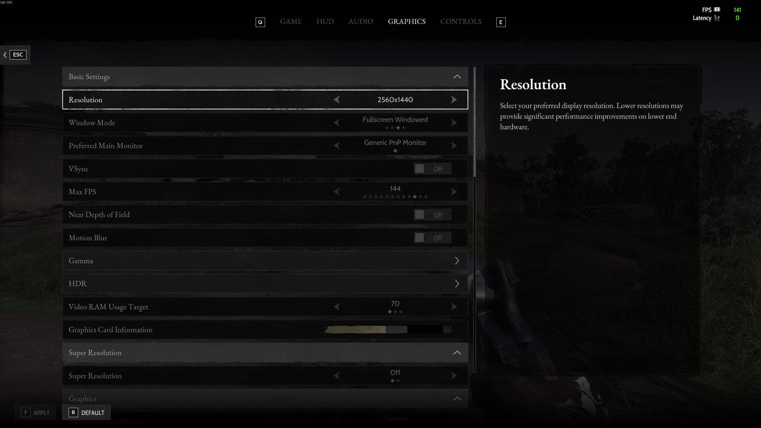

I recorded two separate CapFrameX log, one without deleting the shader cache, and one after deleting the shader cache. The results are clear, i have no stuttering, my average FPS is much higher, 1% lows are much better, the whole game feels really really fluid after deleting the shader cache. If i don't delete it, than my FPS drops dramatically when i aim, zoom in, turn around quickly, but you will see this in the logs. Both have been recorded at the same map, the shooting range, and i did the same stuff, jump around, run around, shoot the targets, quickly turn around etc. Also, i locked the maximum FPS to 144, and when i delete the shader cache, i'm almost always at 144, so my average FPS could be better, but i don't need more FPS, stable 144 with few amount of dips to 120 is really good, but don't forget please, that its possible only when i delete the shader cache file, and start the game.
I also attached three pictures of my current graphics settings. With these settings, the game runs really well, my FPS is locked at 144, and its even capped out most of the time with rare dips to 120 but i don't mind this. My problem is that i need to delete the shader cache file generated by Hunt all the time before i start the game again. Otherwise you will see from the log, that my average FPS is dramatically worse, the game stutters, and i have micro-stuttering.
If you would like to, i can attach my shader cache file too, which causes this. Please tell me if you need it for further investigation.
