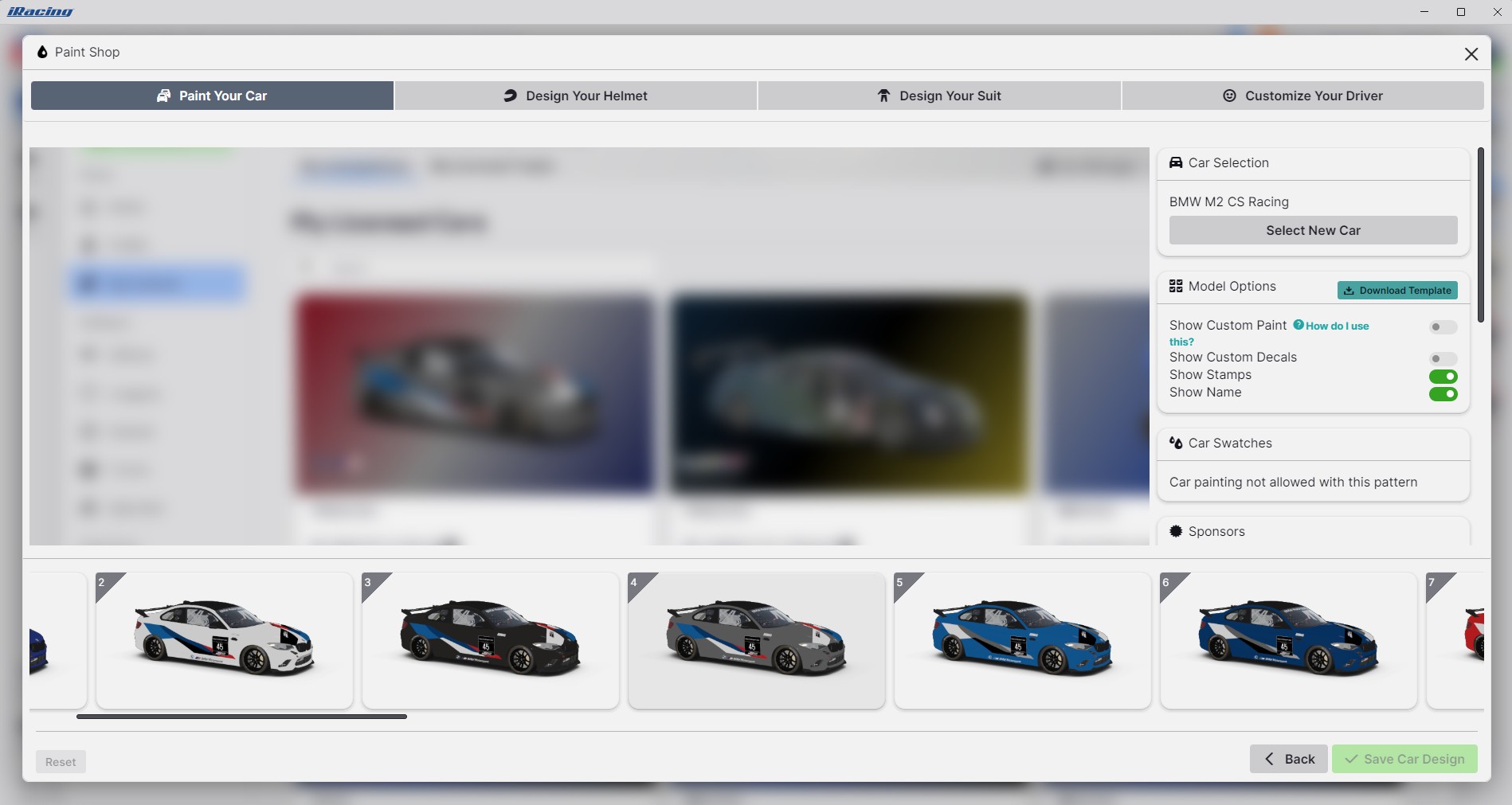

Also, since last year, in the paint shop I can't see the 3D model of the cars (I get a transparent screen). I reported the problem to iRacing support, but unfortunately nothing helped. This error also occurred on my old setup.

1. I don't notice anything that could be related to the bug. When I start Ui after the small loading window when the application window comes in the image freezes, the mouse does not move and for a moment I get a black screen. When the image comes back up I see the welcome iracing sign and it loads fine. Event veiwer shows the error code as above.

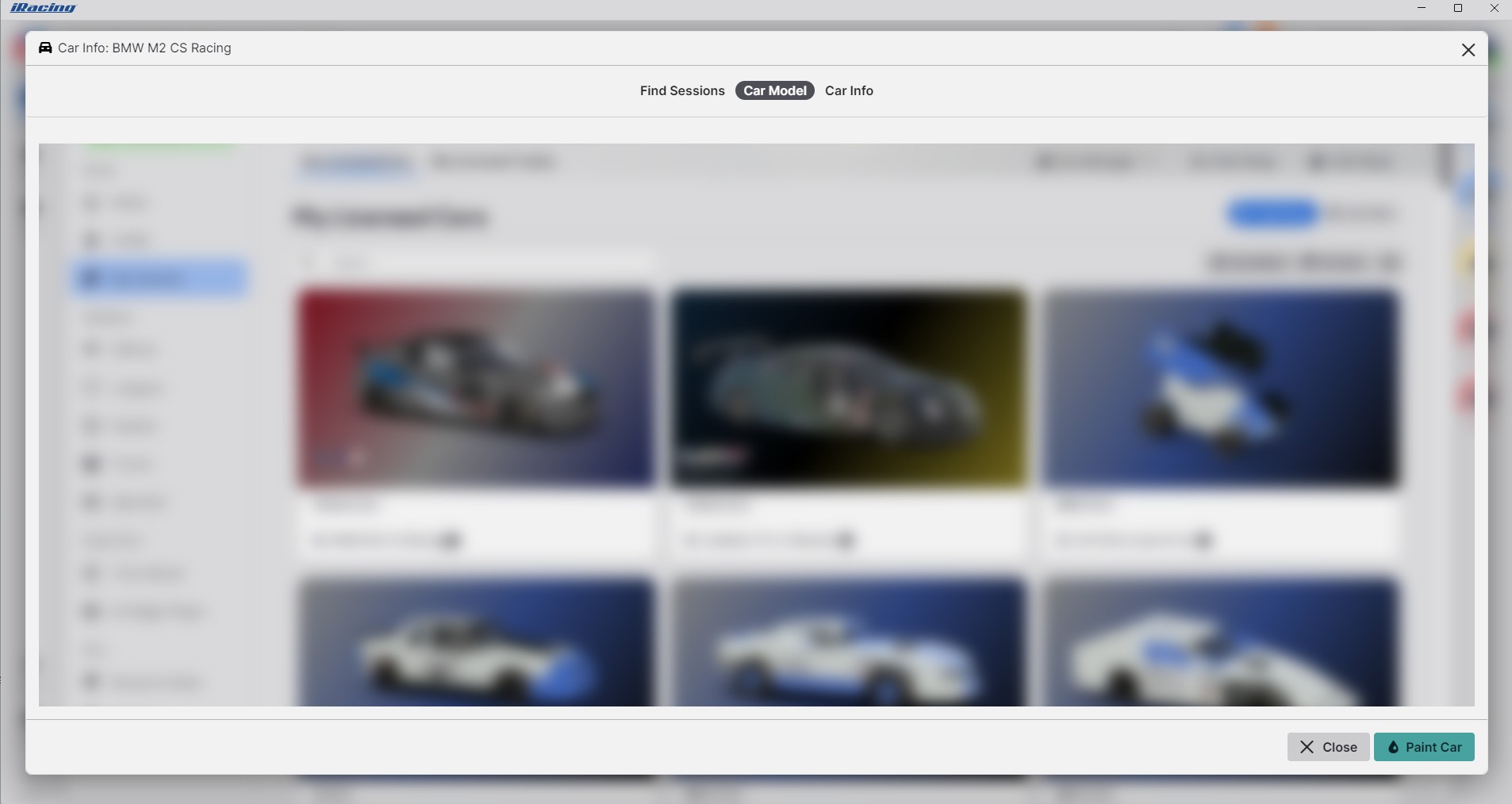

2. The error occurs for all car models. I attach the image.

We conducted tests using our Arc A770 graphics card with driver version 32.0.101.6734 and were unable to replicate the screen blackout issue you described.
However, we did observe that the car model is not visible when viewed in the Paint shop. I will be looking more into this for further investigation, and I will be sharing an update once it's available.

Following our investigation and replication of the issue you reported, I have identified that updating your graphics driver will resolve the problem. I recommend updating to your driver 32.0.101.6874 WHQL Certified to the latest version, 32.0.101.6881 WHQL Certified.
Before proceeding with the update, please ensure you perform a clean installation using Display Driver Uninstaller (DDU). This will help prevent any conflicts or issues during the installation process.

I downloaded the latest driver.
The bug is solved, I can see the 3d model of the cars perfectly.

One bug I've encountered at this time, is in the shop, for cars that are not downloaded, when entering the 3d model menu (where the button says download) the window that opens will start to flicker.
Obviously this is no big deal, just thought I'd let you know.

I'm glad to know that the issue with the 3D model has been resolved now. In regard to the flicker, please give me more time to check and replicate this in our end and will update you again as soon as possible.
