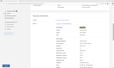

Approx64695
233 Views
Hi Dean,
I have installed the OEM drivers as shown in the attached screenshot.  Unfortunately, the behavior remains the same.  The game started off at 45 fps and dropped to 4 after 10-20 seconds.
I forgot to mention in my original post that part of my initial troubleshooting involved installing the latest Intel drivers, and I'm not sure what Dell drivers I started with, but regardless, both/all drivers have the same issue.
Thanks, appreciate your help.

DeancR_Intel
