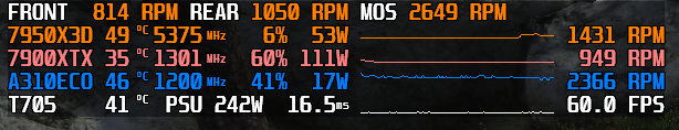

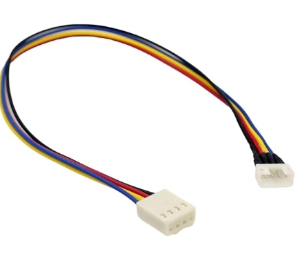

I have taken permanent measures.
That is to purchase such a cable on AliExpress etc.
convert cable arrived, so I made the modification.
fan controlled by the case fan control on the motherboard (X870E Taichi), and set to PWM 25%.
(by the way, this fan will not start at 0-24%. 30% is about 2700 rpm.)
there is absolutely no vibration in the rotation speed.
fan rotation speed error is less than ±10 rpm.
this is the behavior that all users expect!
Do you have the part number you ordered the cable under?
I purchased this on Amazon.co.jp, but the same item is also sold on AliExpress and eBay.
https://www.amazon.co.jp/dp/B0DJZ79KZW
