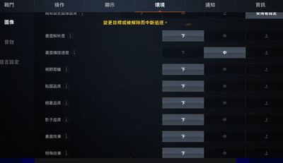

A770在最新版本4502、4514玩Lineage2M時,有機率發生畫面凍結,只能使用工作管理員關閉遊戲,4369沒有這個問題,已多次安裝驅動交叉測試。

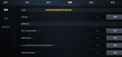

- Take a video of the issue.
- Take screenshots of the game settings.
- Where the game was downloaded? For example Epic, Steam, etc. If possible, provide the link.

Please answer the questions below to be able to start with the troubleshooting steps:
- Provide the link of the website or store where you downloaded the game.
- Take screenshots of the game settings, this is to ease the process of replication in case we need to reproduce the issue.

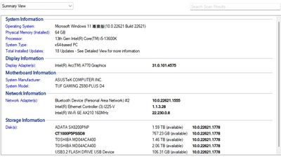

- Download, run, save and attach the report for the following tools to have a better understanding of you system:
- Report for Intel® Graphics Drivers, find the installation steps on How to Install the Intel® Graphics Command Center From the Microsoft Store.
- Intel® System Support Utility for Windows (SSU), you can find the steps on the link How to get the Intel® System Support Utility Logs on Windows.

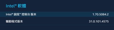

Please follow the steps below and let me know the results:
- Clean install the graphics driver to version 31.0.101.4575 using Display Driver Uninstaller (DDU). For guidance, How to Use the Display Driver Uninstaller (DDU) to Uninstall an Intel® Graphics Driver.
DDU v18.0.6.4
test drive today
Intel® Graphics Driver.0.101.4577
