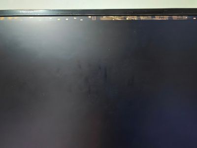

Hello!
Sometimes my system freezes (black screen with a few colored pixels) and then restarts, mostly when I start a game shortly after starting the system.
From the Event Viewer I noticed this error " The computer has rebooted from a bugcheck. The bugcheck was: 0x00000116 (0xffff970f9f661010, 0xffff80541596b00, 0x0000000000000000, 0x000000000000000d). A dump was saved in: C:\WINDOWS\Mini dump\112023-8609-01. dmp. Report Id: 01c592db-278c-4de9-b52f-1547e31c0ad5."
Is this a bug caused by my Arc770 16GB video card? Can someone help me identify and possibly solve the problem?
These are my system details:
Thank you in advance, have a nice day!

Hello Jean, thank you for the quick reply, I will try to give as many details as possible.
- When did the issue start? Is it present since day one?
Yes, it has been present since the first day when I assembled the system with the Intel ARC A770 Limited Edition 16GB video card approximately on November 26, 2022. I initially thought that there were problems with the drivers because they were at the beginning, but over time I installed all the driver versions that they appeared and the problem persisted.
- You mentioned that this issue is when you start a game. What are the affected games?
It's not about a specific title, most recently I encountered the problem with the games Metro Exodus Enhanced Edition and Days Gone, but in the past I also played STAR WARS Jedi Fallen Order, The Witcher 3 Wild Hunt, Counter-Strike Global Offensive, Grand Theft Auto V, Horizon Zero Dawn and the problem was the same.
- Is this issue only present when gaming? Or does it happen on other heavy workload applications?
So far I have only encountered it in games, I tried to overload the card with different test programs such as 3DMark, but the problem did not manifest itself.
- Did you try different driver versions?
Yes, as I mentioned before, I've had this problem since the first day I started using the video card, so I think I've gone through all the driver versions you've released, but the problem hasn't disappeared, although I could say that it manifests itself less often than at the beginning.
- We want to check more details about your system. Create and share a report using the Intel System Support Utility (Intel SSU):
I have attached the requested report to this message.
- Finally, we would like to confirm if you see similarities between your issue and the one reported in this thread. It seems that you both are having the same problem. So we want to ask for this to better look into this matter.
I read that thread, the only similarity I see are those images like the one posted below, it looks like my black screen when the error occurs and the system reboots.
I also watched those two videos, I have never experienced anything like this, nothing similar happens during the game, I mean those white lines and the flickering of the image, for me it simply appears that black screen with those colored pixels after which the system resets.
If you need any other information, I will gladly give it to you.
Thank you, have a great day!

It's sadly an issue people have been reporting for like a year already (me included). This guy even got a brand new card after returning it and it still happened so its related to hardware compatibility issues. Sadly, to this day, Intel seems to be unable to figure out what is causing it. It stopped in my case for some reason but i don't even know what fixed it in the end because i changed so much stuff. My screen still turns off for 1-2 seconds from time to time, and games also give me errors sometimes that the Arc basically died and crashed, but at least my PC does not restart on its own anymore.
If you happen to have browsers or discord open in the background when gaming, try to disable hardware acceleration in those apps. I had weird glitches and issues when i had it enabled like videos sliding across my screen from right to left but i feel like since i disabled it in browsers, discord etc. my system started being more stable.

I have an AMD Mainboard so as you can see all sorts of different configurations can have this issue. And i dont have such an option enabled.
It can also be just some setting that is causing it but i even completely reset my Bios before and reinstalled Windows and it still happened. Intel should really take the extra step imo and ask one of the people with this issue to send in their whole PC and not just the GPU so they can figure out whats wrong since they cant seem to reproduce it on their end.

I see, I think that something doesn't load properly when the PC starts, because in my case the problem is random, it doesn't always appear.

Try "turn off" the ASPM fix. I had a lot of problems with this.

Yes, it improved but the problem still occurs, I tried different settings in the BIOS and with XMP enabled and disabled but no change.
Ok, I'll disable any RAM overclocking settings and use the standard settings (4800 MT/s) for RAMs.

Hi Jean!
Even after I did what you advised me, the problem persists, the bios is reset to the default settings and my RAMs run now at 4800 MT/s and I just encountered another system crash.
Thank you!
