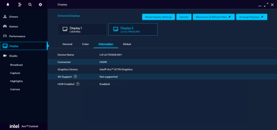

I noticed a recent problem, every time I restart my PC, the refresh rate of my monitor goes to 60hz, VRR is then greyed out too in Arc Control.
I have to completely turn off my monitor screen and turn it back on to get my refresh rate back to 240hz or completely turn off my PC and turn it back on.
My monitor is the LG 27GR95QE-B OLED Gaming Monitor plugged in with the original HDMI 2.1 cable.
GPU ARC A770 16GB

I tested with a 4k 60hz monitor and with my LG 4k 120hz TV, the refresh rate remains the same on reboot. I apparently only have this problem with my gaming monitor on the two HDMI ports.
On the other hand, when I plug my gaming monitor into the HDMI port and the second 4k 60hz monitor (using the display port), I have this same problem again for both monitors upon reboot.
Before reboot
1 monitor's refresh rate is 240hz, HDR is ON and VRR ON
2nd monitor 60hz, and doesn't have HDR 
Arc control: VRR is ON, HDR ON too
Let's reboot
1st monitor is now 60hz and 2nd monitor is 30hz
HDR is clearly OFF on my gaming monitor, that info is correct
VRR is now OFF on my gaming monitor
Intel Arc says HDR is ON but is not, it's off
