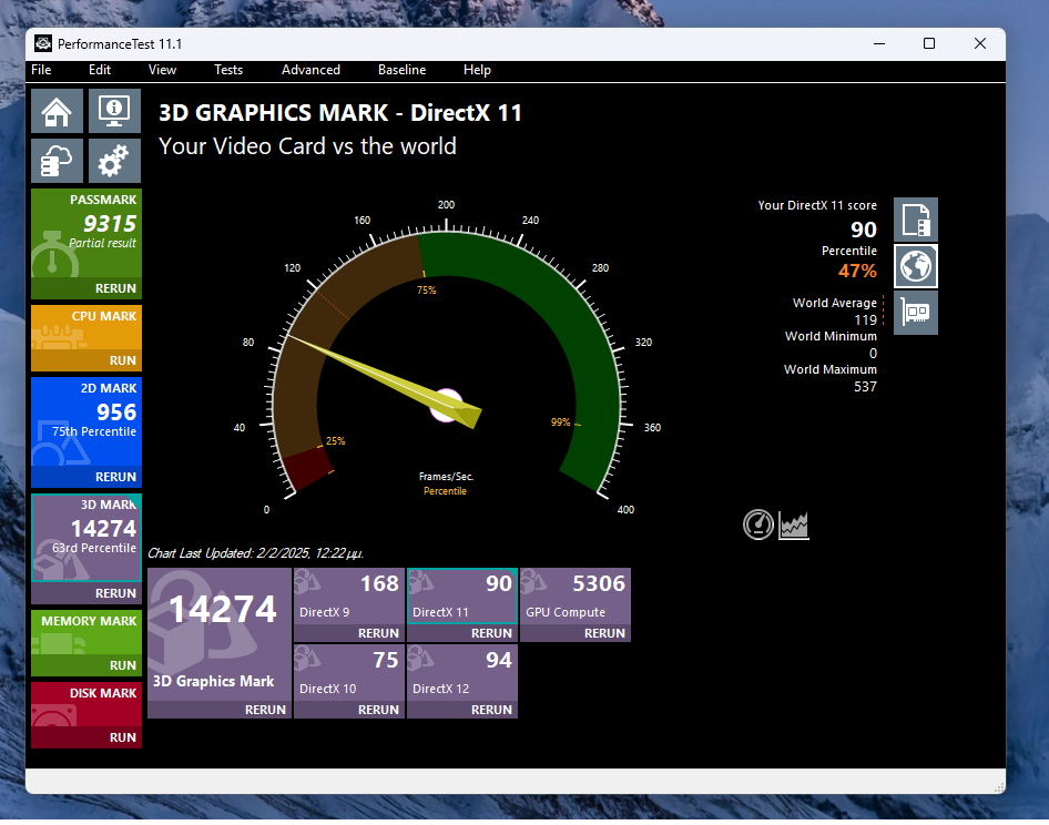

First of all let me clarify that I didn't have any problems/issues until the 6460 driver. However, after the latest driver updates (32.0.101.6557 and 6559 which is WHQL also) I expereince a performance degradation of about 20% in DX9 (framerates have fallen from 210 fps to 170 fps) and somewhat less in DX11 (a drop of 5-10% from 95 fps to 85-90 fps).
My observations are based on the results of passmark's 3D benchmarking tool. Everytime I update to a new driver I run thiese tests to see if everything is OK. And indeed this time after installing either of these drivers (6557 and 6559) the problem is there. Note that DX9 and DX11 benchmarks are the only ones that are affected whereas other passmark 3D benchmark tests (such as DX10, DX12 and gpu compute) have not been affected at all, either posetively of negatively.
I have tried both clean install of the new drivers and full removal of old one (6460) using ddu before installing the new ones from scratch but the problem persists and this is the case for both 6557 and 6559 versions. The latest driver without this issue is the 6460.
My machine is an intel core i5 13400 cpu based desktop equiped with Asrock's intel arc a750 gpu on a Gigabyte B760M DSH DDR4 motherboard (igpu has been disabled from the bios). The system runs windows 11 with all latest updates. Motherboard firmware is also at the latest available version. Note also that NO performance tuning has been applied to the card through the intel graphics software.

Dear Randy T,
I do not have many games so that I can test them and most of those I have are using DX12 or vulkan anyway, where as I said before performance with the new driver is not affected at all. So regarding your first question the drops I observed in indeed based on Passmark's 3D benchmarks, which as far as I know are widely accepted and respected.
Now regarding your second question, I can tell with certainty if other software or task have been affected. I have a feeling that some apps like chrome for example freezes a little bit (I mean from the time the windows appears until it becomes active), but it is so insignificant that I didn't noticed it until the time you post this question. Anyway, even if it happens, it is insignificant so don't take it seriously.
Finally, in response of your third question, I have attached 2 screenshots where you can see the drop in performance in DX9 and DX12 between the 2 drivers (and consequently the overall passmark score has been axed about 800 points - 5%), as well as the respective videos I captured while benchmarking DX9. For the videos I had to lower the quality in order to reduce them into an acceptable size to post them, but I am sure you can see clearly the huge difference in fps displayed on the upper left corner. Note that the fps display is from passmark itself, and not from an external software which may impact the performance.
I have also attached an image from my system specs, as detected by passmark. GPU as I said is Asrock's arc a750

Latest driver 6732 seems to solves the problem, at least for DX9.
For DX11, I remember seeing, in the past, passmark fps values of 95. Now only 88-90.
