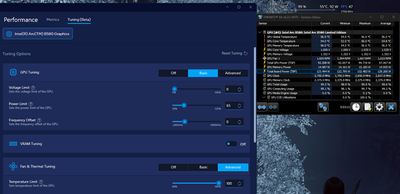

Bonus testing.
Normal
70% Power limit, Normal
68% Power limit, Edge of how much power the game is utilizing. (1-2 watts lower?)
65% obvious 7 watt power reduction.
So in monster hunter wilds. in this scene in particular, my gpu is only at 68% of its TDP but at 100% utilization.
Hope this helped!
(chose monster hunter as an example, i could do the same for every game, but you get the idea)

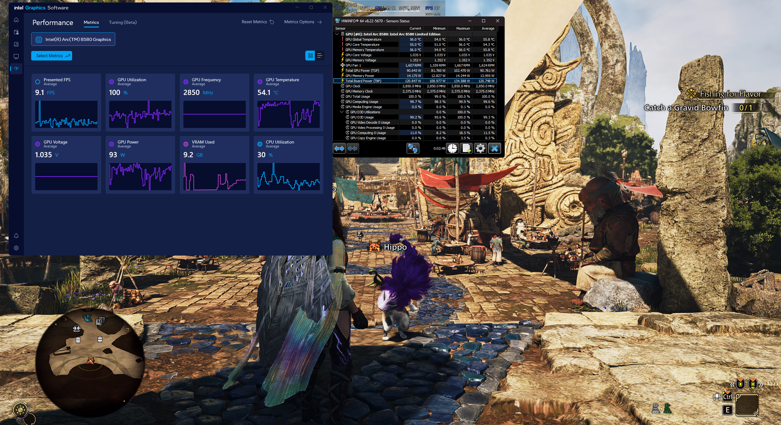

I moved to different areas for this comparison.
All the images are with the GPU on Default settings. (unless marked otherwise)
When moving into a harder to render area, power usage goes down.
I have here examples of the Gathering Hub and The windward plains.
I also have an example of looking directly up in the Gathering hub and getting higher power usages.
At the end here, i have an overclocked screenshot.
Even with 60% more voltage and a +350Mhz overclock. im still nowhere near the TDP of 190w
This is just monster hunter wilds, other games have this issue as well, Call of duty warzone i was playing yesterday, and while overclocking with the same settings i was only able to reach 170w of total board usage after playing for an hour and a half, with most of the time it being around 150w (the average was 152w)
I should have taken a screenshot.
Either way i hope this helps and if there is any other examples you need me to provide i will be happy to do so.
Important side note: When the intel software reports 146w of usage, the GPU is actually using 190W of total board power, which hits the 100% wattage limit in your software.
Example,
(TBP 190w) (TGP 146w)
Intel software only reports TGP which does not show the entire power usage.
TBP includes power supplied by the motherboard.
So in your testing, you should look for a target of (146w TGP) to reach the (100% 190w limit), and (175w TGP) to hit the (120% 228W limit.)
