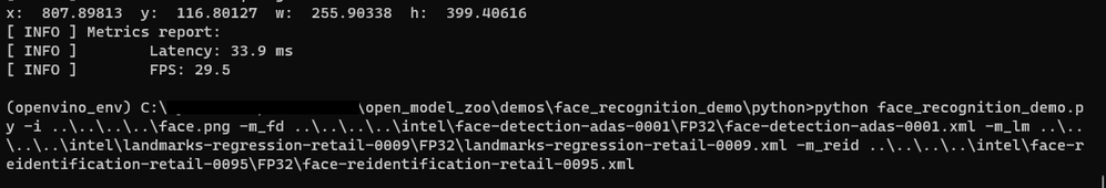

For your information, I was able to replicate the issue you observed with the Face Detection step. But, I received some errors in the Python code and had to change a few lines for it to work. I share the results here:
C++
x: 807.676 y: 117.246 w: 256.247 h: 399.059
Python
x: 807.89813 y: 116.80127 w: 255.90338 h: 399.40616
C++:
Python:
Python Code:

We have tried comparing the results on our end from the modified demos.
From our investigation, we did not encounter huge differences and the pixel differences were minor and did not impact the accuracy of our result. We show the result here:
Face Detection model
C++
Python

We ran the inference using the sample image attached. Could you please help to try and run your code with our example image and see if you get the same result as ours?
If you get the same result as ours, please help to provide us with the sample image/video that you used that gave you the 30-pixel difference result, so that we can replicate it.
Megat
saeidn95
3,072 Views
Hello Megat,
Thanks for the due diligence.
Yes I am I  getting similar results on your test image.
In your outputs  for point  33 you get:
C++ 33: x: 1073 y: 319
Python-: 33  x: 1060.253744983529 y: 328.09794247042737
This is a difference of dx = 13 and dy = 9.
For some images I get a difference as large as 30 pixels.
Five  points for your consideration as you improve your tools:
a. I was just reporting my observations that I thought software developers in  Openvino team in Intel would be interested to know in their development efforts. What you do with it is your call of course.
b. It matters in a chain of networks in gaze estimation as the inaccuracies propagate and amplify, where the pose estimation can be off by a few degrees.
c. It is not so much the difference but where the difference come from? my understanding is that the  backend is the same for both C++ and Python.
d. How do you measure accuracy? Is  dx = 13 is accurate enough?  How far dx/dv  has to deviate before it is called inaccurate?
e. Is there a upper bound on the difference? As I said I have seen difference as high as 30 pixels, before I reported my observations to you.  Unfortunately, I cannot member which image I used to send it to you to replicate, but they were grayscale for use in driver-monitoring system. You can try a few different grayscale images that are available to you.
