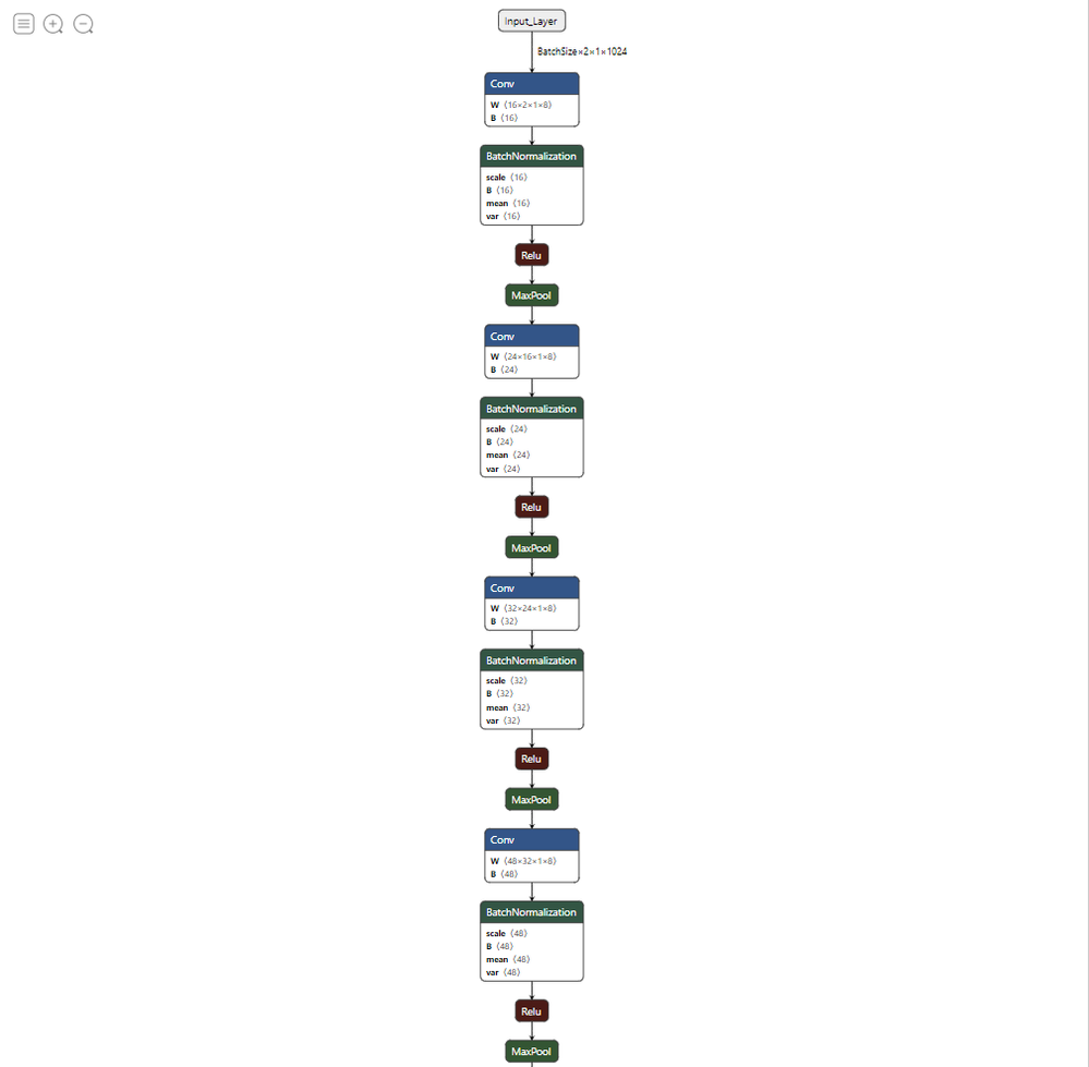

I have issue while converting ONNX transfered from MATLAB to IR files.
My running environment: MacOS 11.0.1 Python3.8 OpenVINO2021.2.185
I have attached the onnx file in Train.onnx.zip
XudeMacBook:model_optimizer xuhe$ python3 mo_onnx.py --input_model Train.onnx

[ ERROR ]  Exception occurred during running replacer "REPLACEMENT_ID" (<class 'extensions.middle.DecomposeBias.DecomposeBias'>): After partial shape inference were found shape collision for node CNN1 (old shape: [   0   16    1 1024], new shape: [  -1   16    1 1024])

May I know which onnx model that you were using? (eg: topologies, framework layers).
Plus, I would like to confirm whether your current model is using dynamic shape for the input?
If you are, the dynamic shape for RNN/GRU for ONNX model is yet to be supported. However, our developers have worked on this in Feb 2021 and possible implementation on the next version release of OV - ONNX RNN/GRU enable dynamic input shape by mitruska · Pull Request #4241 · openvinotoolkit/openvino ...

Sorry, I don't really understand what's the difference between topology and framework layer. I think my onnx model is framework layer. Here is my operation process on MATLAB :
https://ww2.mathworks.cn/help/comm/ug/modulation-classification-with-deep-learning.html?searchHighlight=modulation%20classification%20with%20deep%20learning&s_tid=srchtitle
 I tried the dynamic input shape by typing" --input_shape[-1,16,1,1024]'', as the ERROR told me, while it told me that it was unrecognized arguments.

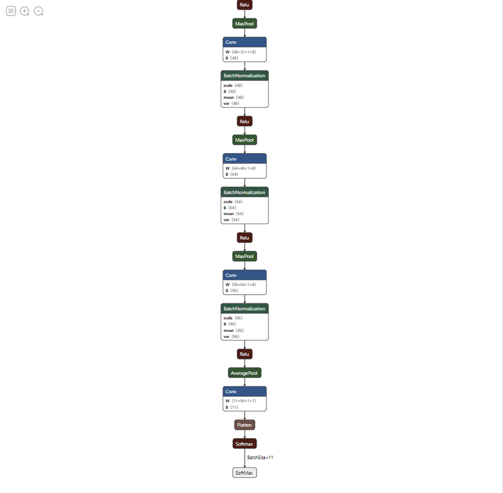

This is the design of my trained network.
Sincerely,
Jerry
Iffa_Intel
1,838 Views
It seems that the input_shape was incorrect in Train.onnx model. This is the reason for the error that persist.
You need to use input_shape parameter with the correct formatting [1,1,32,WIDTH>] as proposed by Evgeny (how to use dynamic shape ? · Issue #436 · openvinotoolkit/openvino (github.com)), the success result is as below.
Please help to implement one of these options:
1) Fix the input shape in the model to follow OV formatting : [1,1,16,WIDTH>] and run mo.py without input_shape parameter
2) Specify the input_shape during model conversion and follow the exact format: [1,1,16,1024]
Sincerely,
Iffa
