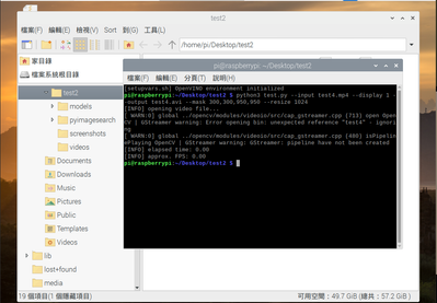

I can't see what's wrong
dengyu
2,071 Views
I can run it smoothly with the test video provided by the original author
But I'm getting this error message when testing with a video I shot.
The window size of the video I shot has been modified to 1980*1080, but it still cannot be executed.
Please assist me, thanks.

Please share these details for replication purposes:
Sincerely,
Zulkifli
dengyu
2,026 Views
1. OPENVINO NO:  2020.1.023
2. Build OpenVINO from the source
3.https://github.com/nikogamulin/counting-cars
4. The video was taken from my phone.
Thank you,SIR
Zulkifli_Intel
2,019 Views
Hello Dengyu,
Thank you for sharing the useful information with us. Could you also share the video taken using your phone? If the file is too big, you can put it in Google Drive and share the link here.

dengyu
2,012 Views
please check, sir
Zulkifli_Intel
1,987 Views
Hello Dengyu,
We are still investigating this matter and it may take some time since you are using an outdated version of OpenVINO.
Also, try using --resize 320,240 instead of --resize 1024 and see if that makes any difference.
Sincerely,
Zulkifli
dengyu
1,975 Views
I have figured out the problem, thank you, Sir

dengyu
1,964 Views
I made a stupid mistake
1. Video format needs to be 1980x 1080
2. Filename English uppercase and lowercase
Sorry, Sir.
