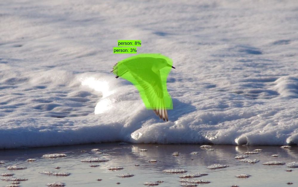

Inference is faster but i noticed that network detects much less things through OpenVino than directly with tensorflow, what can be the reason ?
Following images, are issued from inference with original model from tensorflow zoo, issues are the same.
Open Vino :
Bird_VinoHuman_Vino
TensorFlow :
Bird_TFHuman_TF
As you can see, there is big differences :
  • Some class not detected
  • Probability are much lower than with TF

Hi @Francois, I believe the --reverse_input_channels can solve your problem. I have just tested the model with both code in C++ and Python and the result is exactly the same (as good as I expected). Try it and tell me the news :D . I am happy now that I can continue with Python.

I'm not quite sure but can you redo your optimizer with arg --reverse_input_channels . I just improved the result with adding it.

Thanks for your advise ! It solved my problem !
I don't know why but cpp code by OpenCV4.0.1 expect different export than python code.
