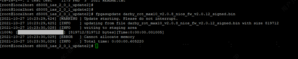

    I Installed the d5005_pac_ias_2_0_1_pv_dev_installer.tar.gz three month ago,  It seems that the dev stack  is installed successfully by check the opae software version and fme version. Then I installed the update package d5005_ias_2_0_1_update2.tar.gz,  a error [Cannot allocate memory] teminated the process,   How can I solve the problem?  Looking forward your help as soon as possible,

Could you provide me the log file when you performed "sudo fpgainfo fme"?
