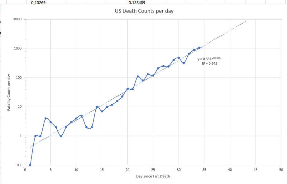

Jim: Thanks for the comment.  I am looking for the harmonics (poor term) under the linear regression in log-linear frame of reference.
We passed 1000 a day earlier than I expected a week ago, the slope on the underlying linear regression analysis is upward -- very slowly.
HIME - University of Washington estimates 2500 peak in the middle of April -- they I think are wrong -- we should hit 2000 by Sunday

Question - is the data for the 4th at the 1000 line - a bend over in the line or a harmonic.

This is probably a naive observation.
The chart in #17 looks linear, even with discarding the first 15 days or so, which may not have sufficient contributing numbers to be meaningful.
Past this point (15 days), a number of practices have been implemented in an attempt to slow the progression. Ask you self: Why does each attempt at mitigating the spread appear to have no effect? Social distancing, stay at home, wash hands, no touch face, wear face mask, etc.... each of these suggestions have come in at different points in time. Why no change in slope?

your question cannot be answered today -- but it is the key question -- is this a harmonic or a slope change - I suspect harmonic
