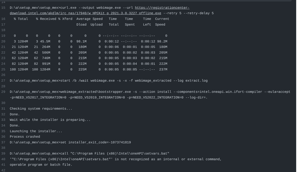

I tried installing oneAPI 2021 Fortran compilers on Windows Server 2022 using the following batch script.

The installation always fails, saying
Checking system requirements...
Done.
Wait while the installer is preparing...
Done.
Launching the installer...
Process crashed
D:\a\setup_mex\setup_mex>set installer_exit_code=-1073741819
A screenshot is as follows
In contrast, the same script works well on Windows Server 2019. Is this a known issue or did I overlook something?
