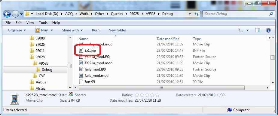

aqui
2,634 Views
I'm still no further forward with this. Here is a screenshot of the Project Settings:
Settings
And here is one showing the location of the specified input file:
path
Any further assistance that anybody is able to provide would be much appreciated.
Adam

"Operators" < and > are used for standard input and output redirection (thus, have nothing to do with "list-directed", which is a Fortran term). Now, strictly speaking, the redirection is a command of command line interpreter (cmd.exe) and may not work automatically in other programs. Visual Studio possibly executes the console program directly (not throuth cmd.exe) and thus the redirection symbols may not work as expected.
Here Steve mentioned that the feature sort of works in Visual Studio, but for some reason you have to specify full paths to the input and output files (D:\ACQ\...\Ex1.inp).
Alternatively, you may try to invoke cmd.exe by setting:
Command: cmd.exe
Command arguments: /C $(TargetPath) Ex1.out

IanH
2,634 Views
Two suggestions:
- If you haven't already, install SP1 for VS2008, which apparently fixes this - see here.
- Write a little debug function that does the redirection inside your program. If the first argument has the magic word then the input and output units are reconnected appropriately.
