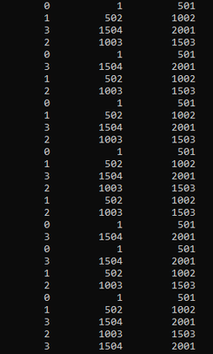

Add some diagnostic code:
c*************************************************************
iend_k = INOD
NPROC_k = NPROC
nstep_k = 1 + ( iend_k / NPROC_k )
small = 1.e-6
!$OMP PARALLEL DO
!$OMP+ DEFAULT (SHARED)
!$OMP+ PRIVATE( ll, is, ie, I, IJ, ahu_p_max )
DO k = 1, NPROC_k
is = 1 + (k-1) * nstep_k
ie = k * nstep_k
is = max ( is, istart_k )
ie = min ( ie, iend_k )
!$omp critical
print *, omp_get_thread_num(), is, ie
!$omp end critical
ahu_p_max = small
do ll = is, ie
ij = Nodes(ll)
ahu_p_max = amax1( ahu_p_max, ah_p(ij) )
enddo
fi_pr_1(k) = ahu_p_max
ENDDO
!$OMP END PARALLEL DO
ahu_p_max = 1.
do k = 1, nproc
ahu_p_max = amax1( ahu_p_max, fi_pr_1(k) )
enddo
Jim Dempsey

Here  is the screenshot after inserting critical + print:
For me it looks like it should be. Just to mention: INOD = 2001.
