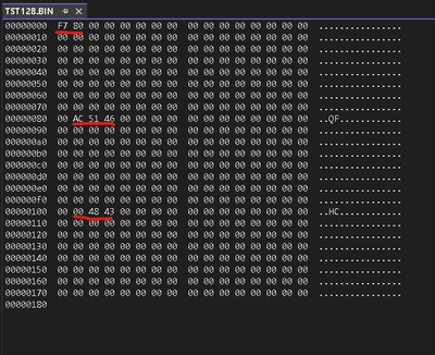

sindizzy
16,897 Views
In Intel IFORT without byterecl I get the following if I use RECL=20000 or RECL=5500
Same if I do use byterecl

I just found a clue.
The second and third bytes 55F0 is the decimal representation of the number 22000. So it is the record length and it is stored by Lahey Fortan in each record or in only the first. Can you change you test program with a record of 128 for example and post the hex dump of the first 256 bytes of tst.bin file.

And here is the hex dump. Would F7 be a possible header marker? 80=128
13419.0 = 0x00ac5146 (big endian)
200.0 = 0x00004843
GVautier
New Contributor III
15,945 Views
It becomes clearer. The first record looks like a header with a 1 byte marker and the record length in the 4 to 8 following bytes.
In order to read this file with a program compiled with Intel Fortran, you must shift your record number to skip the header : REC=2 for the first record and so on.
