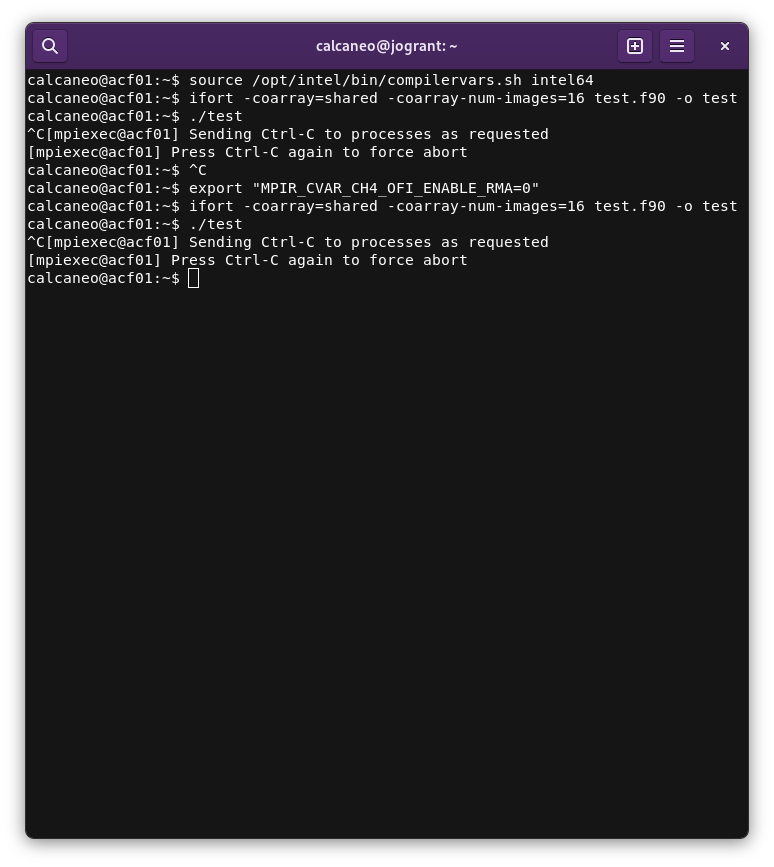

We have successfully installed the Fortran compiler and are able do compile code. The problem is we cannot seem to run de code on more than 15 processors. Our server has 56 processors available to us, but the code hangs if we try to run on more than 15.
Does any one have an idea what could we be doing wrong?

Can you please upgrade to the current compiler release? ifort is now at 2021.6.0. The Fortran compilers are available as part of the oneAPI HPC Toolkit. You can download it here.
I suspect there are bug fixes in the last 4 years that may impact your issue.
BTW, MPIR_CVAR_CH4_OFI_ENABLE_RMA=0 only impacts distributed coarrays using IB.

Your title says errors, but the text says hangs. Could it be that your application isn't coded in such a way to scale beyond 15 images? What happens if you try a simple program such as this?

You still haven't said what exactly goes wrong. If there is an error message, please show us the complete and exact text.

ifort -coarray=distributed -coarray-num-images=8 test.f90 -o test  (eg for 8 processors).
I am attaching the result, when we use more than 15 processors the program does not respond ans we have to make a hard break.

Try setting the (an) environment variable I_MPI_DEBUG=5
Then run the program (with more than 15 processes).

What version of the Intel Fortran compiler are you using?
If you are running on a single server, you can use -coarray=shared. Does that work for more than 15 processes?
What MPI fabric are you using? There is a known bug with OFI/mlx over IB and using distributed coarrays . As a workaround, try setting this environment variable:  MPIR_CVAR_CH4_OFI_ENABLE_RMA=0. Another workaround is to use OFI/psm3.

Sorry, I forgot to mention, we are using Intel parallel studio 2017

We can know play with this compiler!!! We have succeeded in installing and compiling the "hello world" code, so now the work begins! (please see image)

GOOD NEWS!!  But please use ifort for now. It looks like you might have used ifx.
Be aware that ifx has limited co-array support; we sneaked it in there. With the next release co-array support is planned to be complete and official. See this article for information about the Fortran and OpenMP implementations in ifx available today.
