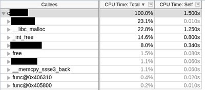

Here are the "Callees" from VTune for the problem routine (redacted name beginning with "c") compiled with oneapi 2022 (ifort). All the redacted names are in our production code.
This routine took 21.7 seconds (26.1%) of the total CPU time of 83.1 seconds. Most of that time is spent in for_alloc_assign_v2, for_alloc_copy and for_alloc_all_nocheck rather than in the application code.

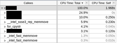

For comparison, the equivalent result from version 16 is
In this case the "c" routine takes 3.9 seconds (6.7%) of the total CPU time of 58.33s
Finally this is the result with gfortran 11.2
Here the "c" routine takes 5.5 seconds (7.9%) of the total CPU time of 69.3 seconds.

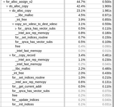

Could you expand, expand, ... for_alloc_assign_v2 to narrow the issue further?
This may lead into functions without debug information, which is OK
Getting the names may be insightful as to if/where a mutex might be located or if this is mostly memory reference overhead.
Note, the very high functions can be opened in a Disassembly window for further inspection.
Jim Dempsey
Here is the expansion of for_alloc_assign_v2 callees:
