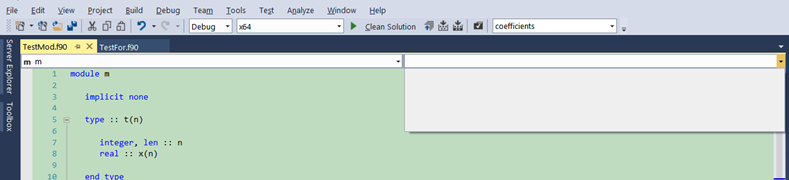

With Visual Studio 2013 and Intel Fortran integration using compiler 2015, update 2, the members drop-down for the source window in the IDE shows up empty for the simple module code shown below.  Hopefully the problem is reproducible and it can be directed for a resolution.

Here' a screen image of the source window in the IDE that shows the empty list:

FWIW, line 13 (where a PDT is a component of a derived type) seems to be the issue; commenting that line out immediately adds init to the members drop-down list.
