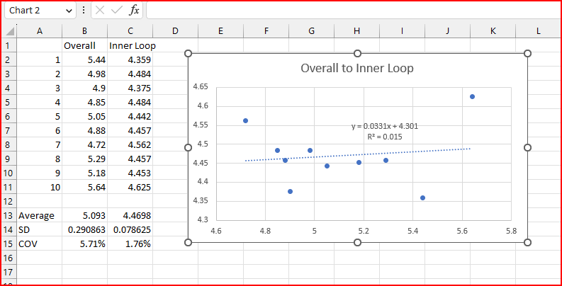

Adding an old timer, I get on a Dell CORE i7 11th Gen Intel(R) Core(TM) i7-11850H @ 2.50GHz 2.50 GHz
Core I7 10710U has a pass mark score of 9848
Core I7 11850H has a pass mark score of 20,867
I am running 64 - release with Windows 11 Preview.  I got one at 3.9 seconds, but it had a high overall so I discarded it.
I am running 2023 Fortran
IFX runs in 22+ seconds.
I wonder if W11 is the difference, your machine is a bit faster.
Running your program on IFORT is 4.5 seconds.

The timings shown by JohnNichols confirm that for this program the IFX compiled EXE takes many times (~5) longer than the EXE compiled with IFORT.

Are you running on LINUX? This might explain the difference between your results and mine.
The interesting thing to explain to masters students is that experiments need to be repeated, there is no point doing a Bridge to Far exercise to find out the 82nd stuffed it at Nijmegen and you are hanging out in enemy land.
I define enemy land as any reviewer with a chip on their shoulder.  ie all reviewers.

I ran it in the CMD Window for IFORT 64 bit, it ran 0.3 seconds slower on average.
How did you get to 2.8 seconds?

So this thread took a bit of a tangent. In that regard, I'm attaching what I believe is a working version of the fpu benchmarking program that I created. I didn't test it as far as the ifx slowdown issue. I think the original code I posted shows that well. This update is meant to show the correct GFLOPS numbers. You may have to tweak some of the internal variables and spreadsheet calculations, if you're cpu is substantially different than mine. However, I think this will work for a lot of processors that support AVX-512.
Update:
I did some quick tests comparing compilers and this was the result. On my actual codes, I don't see this type of slowdown. So I was surprised to see this on such a simple code.
