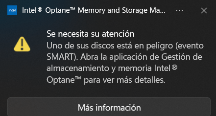

I have a 15dyxx core i7 1165g7 laptop with iris xe that was given to me 15 days ago and I saw that it has intel optane technology, however a message appears saying that there are no valid disk pairs in the system
the images are in spanish but its the same issue as in english
I did not give it much importance, however when installing heavy apps between 50 or 60 GB or more I get an error message that
says one of my drives is at risk followed by SMART event
It should be said that this only appears when installing heavy applications such as games of more than 30 GB
When I give more information it takes me to the optane application and I click on scan and it tells me that the disk is at risk I click on delete smart and it tells me that it could not be deleted
However, after a few minutes or seconds, when I scan it again, it tells me that the hard drive is working correctly and it appears green again, I think because right after the installation of the heavy apps is finished, it sort of returns to normal

When this message shows up, it is important to confirm if your system has an Intel Optane Memory installed, and if it does not, the message is just informational and the notification can be disabled; you may also review with the system manufacturer if the "Intel Optane Memory and Storage Management" application can be safely removed since it is not really required.
Additional details in this article: https://www.intel.com/content/www/us/en/support/articles/000090028/memory-and-storage/intel-optane-memory.html
Your system does not have an Intel Optane Memory according to the information you have shared, only a Samsung NVMe disk, which means the Intel Optane Memory and Storage Management is not required and you can disable the notification as mentioned in that article:
  1. Go to Start Menu > Settings System Notifications and Actions.
  2. Select the Intel Optane Memory and Storage Management application.
  3. Toggle notifications Off.
Regarding the SSD SMART event, this must be reviewed with either the SSD manufacturer or the system manufacturer, since the Intel Optane Memory and Storage Management is not an SSD diagnostic tool, it will just show there is a SMART event, or you may use the tools provided by Samsung to monitor the SSD health:
