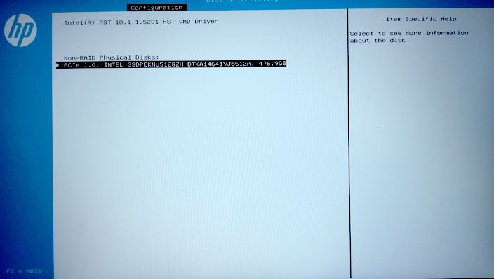

I actually think this SSD is OEM hardware in a HP laptop 17-cn1003ca with an 11th Gen i5-1155G7 processor; AMI BIOS which reads the drive as an Intel SSDPEKNU512GZH (which matches the sticker on the drive) with NVMe controller. I don't see anything about enabling caching. When I got this laptop it had Windows 11 installed (with which I've never actually fallen in love) so I deleted that OS and have been running Linux Ubuntu on this SSD for the last several months, but would like to go back to Windows 10, which on install is arguing with me about needing a driver. The BIOS reads the drive, but Win10 doesn't like it. The driver installation .exe file I downloaded for this SSD (which, according to the included readme file) should be able to be extracted yielding the desired/required .inf files does not seem to work as described. Maybe I'm doing something wrong there?

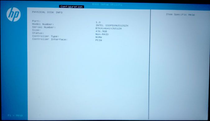

Here are some screen shots of the BIOS. There does not seem to be any way to turn UEFI off, so it appears to be in the ON state by default. There is no option in this BIOS for legacy boot.
lwalper
15,577 Views
Let me attach those inline -- easier to see.
Bios 1Bios 1Bios 2Bios 2Bios 3Bios 3Bios 4Bios 4Bios 5 - drive infoBios 5 - drive info

Hi @lwalper
The problem you have is a HP laptop problem. I've "googled" little and found a threads describing similar problem and proposing solution how to solve it.
Thread 1
Thread 2.
Thread 3.
Leon

LeonWaksman
15,364 Views
From the third link I gave in my previous post, you can download this driver, needed for installation.
Leon
