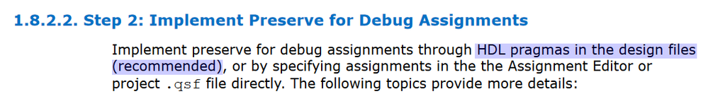

Thank you but this is exactly the document I used (cf. the above screenshot).
Your statements differ from what is in the documentation.
I don't do anything wrong, I even do what is recommended.
Once more, the pragma preserve_for_debug is broken, it doesn't preserve the signals.
sstrell
3,826 Views
Yes, and then it says "by specifying assignments in the Assignment Editor or project .qsf file directly."  There are multiple methods for using this.
I'm not saying you did anything wrong but again, what you are trying to preserve with this is not what this feature is for.  Use virtual pin assignments and you will be good to go.
preserve_for_debug is for internal signals, not outputs.
I quoted the documentation showing it is meant for my situation.
virtual pins aren't mentioned in the doc, nowhere for debugging purpose.
I feel like this "technique" is just a work-around that people have been used and advised for years (and convinced themselves it's the way to go) just due to the lack of proper support for debugging.
After the Xilinx's mark_debug experience, this technique seems very inefficient and a huge step back to the past.
there no such limitations written in the doc, quite the opposite
"sigtodebug" is an output of a module, not an output pin, therefore it is an internal signal
