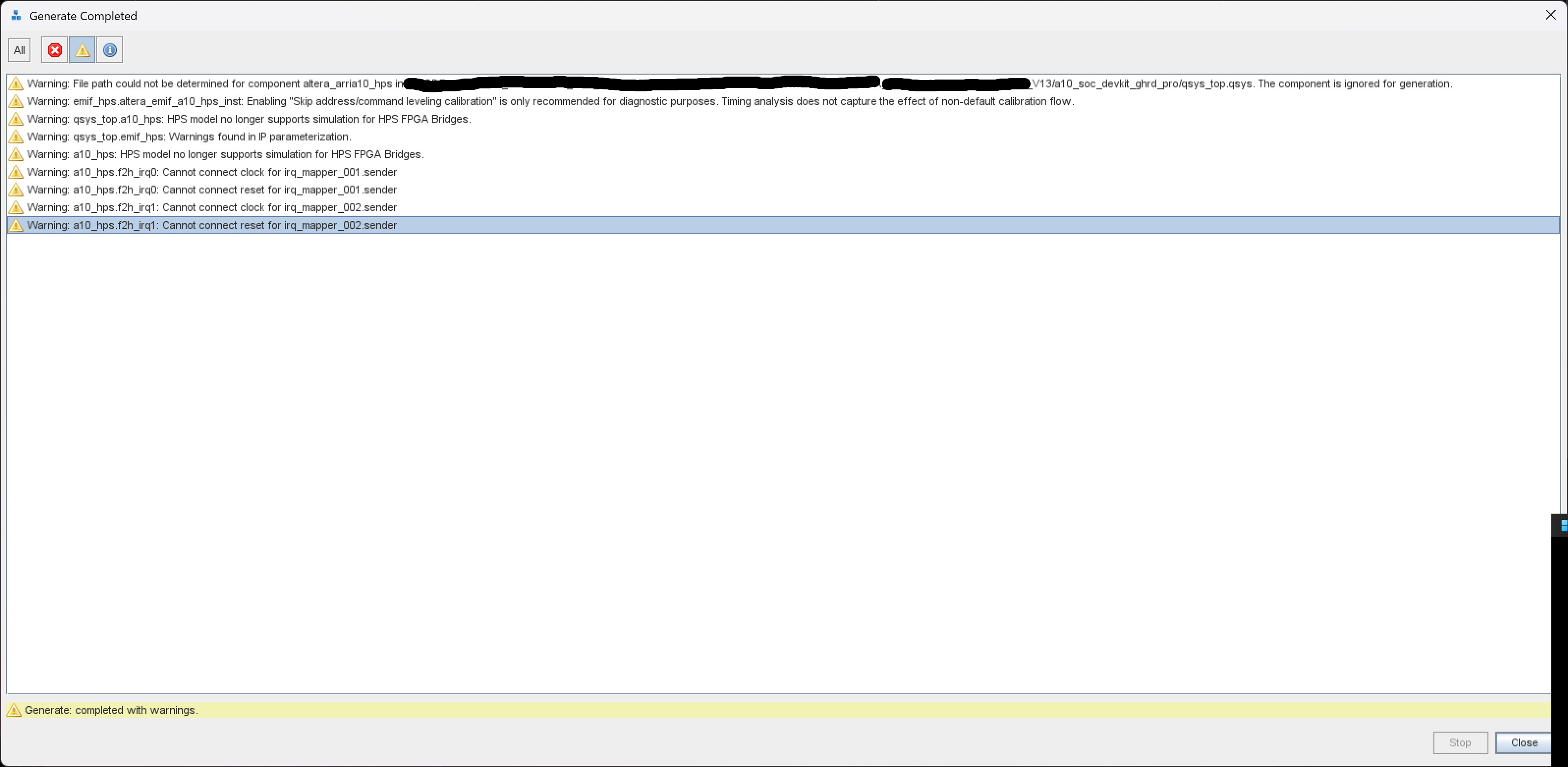

I am trying to generate my ARRIA10 SoC Development kit in Platform Designer.
When I click on the a10_hps - > System Info:
Component Instatiation: a10_hps
IP File: (NONE)
I have tried to install different kinds of Tools, Folders etc. but nothing changed.
Further I allways get the Warnings:
Warning: File path could not be determined for component altera_arria10_hps in C:/Projects/DLR_C10303/DLR_BSR_Modem_FPGA_P2254/Dokumentation/Software/FPGA/FPGA_BSR_Projects/BSRFPGA_SW_V10/qsys_top.qsys. The component is ignored for generation.
Warning: qsys_top.a10_hps: HPS model no longer supports simulation for HPS FPGA Bridges.
Warning: a10_hps: HPS model no longer supports simulation for HPS FPGA Bridges.
Warning: a10_hps.f2h_irq0: Cannot connect clock for irq_mapper_001.sender
Warning: a10_hps.f2h_irq0: Cannot connect reset for irq_mapper_001.sender
Warning: a10_hps.f2h_irq1: Cannot connect clock for irq_mapper_002.sender
Warning: a10_hps.f2h_irq1: Cannot connect reset for irq_mapper_002.sender
When I try to open:
ip/qsys_top/qsys_top_hps_0.ip
I get:
Error: altera_hps: couldn't read file "C:/altera_pro/25.1.1/quartus/../ip/altera/alt_mem_if/alt_mem_if_interfaces/alt_mem_if_hps_emif/common_hps_emif.tcl"
(file line 2)
invoked from within
"source "$env(QUARTUS_ROOTDIR)/../ip/altera/alt_mem_if/alt_mem_if_interfaces/alt_mem_if_hps_emif/common_hps_emif.tcl""
(file "C:/altera_pro/25.1.1/ip/altera/hps/altera_hps/altera_hps_hw.tcl" line 42)
Tools I use:
- Quartus Prime Pro 25.1.1 with Licence
- Arria 10 device Support
- EDA Libraries
How do you generate your a10_hps Projects?
And How do I get a valid a10_hps into the catalog?
Thanx for your help.
I am going crazy aufter 3 Weeks of trying and installing.
Greez Linus

Your screenshots are too low res to see anything on them.
You probably need to generate a license file and license Quartus since you are using Pro.
I also realized this recently that there is no .ip file for the HPS itself, but all the HPS related parameters can be found in .qsys file of the project. No ideas why though..

So there is only something wrong with my Projekt and i do not need to search for any a10_has.qip files .
And I can ignore the Platform Designer - Generate HDL - Warning:
"Warning: File path could not be determined for component altera_arria10_hps in .../Dokumentation/Software/FPGA/FPGA_BSR_Projects/BSRFPGA_SW_V12/qsys_top.qsys. The component is ignored for generation."
Greez
I would not ignore that warning, but yeah there shouldn't be any .ip or .qip file necessary for the HPS. I can't tell much because the picture quality is low and I can't read..
