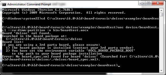

Hello for anyone,
my friends, What's this, i don't understand.
12 Replies
Altera_Forum
1,925 Views
From what I can see, you are not at all supplying the --board switch with your board name in the command line. Also make sure that "board_spec.xml" does exist in the path that the "AOCL_BOARD_ROOT_PACKAGE" is pointing to; it seems in your case, AOC cannot find that file either. I am not sure but based on the error message, it seems you might have to use slash ("/") instead of backslash ("\") for the environmental variables related to AOC on windows.

Thanks for the reply, I used the "--board" switch as you suggested and compilation started. But this time I have another error, it says: "Error: Qsys-script FAILED.". I looked at the log file and there is the same error for different examples (boardtest, hello_world, etc.). There writes: "Error: add_connection acl_iface.kernel_irq boardtest_system.kernel_irq: No interface named acl_iface.kernel_irq."
Any suggestions?
Altera_Forum
1,925 Views
Please post the exact command line you are using, full "quartus_sh_compile.log", and also your version of Quartus. If you are using v16.1.0 or below, make sure to update to v16.1.1 first. If you are updating from a major version to a minor one (e.g. 16.1.0 to 16.1.1), make sure you install the update for both Quartus and AOC (they are separate).

Hi HRZ,
I was using version 16.0.0 and I upgraded to 16.1. I am using Terasic DE1-SoC board and trying to run the examples as explained in "http://www.terasic.com.tw/attachment/archive/836/DE1SOC_OpenCL_v02.pdf".My operating system is Windows 7 x64. I wrote the command "c:\intelFPGA\16.1\hld\board\terasic\de1soc\examples\boardtest>aoc device\boardtest.cl --sw-dimm-partition --board de1soc_sharedonly -o bin\boardtest.aocx" at command line. The result is the same as previous versions result, the error is: "Error: Qsys-script FAILED. Refer to boardtest/boardtest.log for details." I attached the log file. There is a difference in log file according to version 16.0.0. There was one error line in previous version, but now there is two error lines.
Waiting for your help, thanks in advance.
Altera_Forum
1,925 Views
There is another log file called "quartus_sh_compile.log"; please post that one since it includes a lot more debugging info. The errors seem to be related to some interface mismatch; looks like a BSP problem. Are you using the new BSP v16.0 from Terasic (http://cd-de1-soc.terasic.com/)?

Okay, I didn't realize 16.1.2 was also out but that should also be okay. I tried the boardtest with Terasic's BSP on my own environment (though I am on Linux), it certainly works and does not give the error you get. I believe there must be some issue with either your environment or the way you have installed the BSP. Have you followed the steps in Terasic's OpenCL User Manual, Section 2.1 Software Installation, properly? I recommend reading and following those steps again and paying extra attention when setting the environmental variables. If it doesn't fix your problem, you should contact Terasic directly, this might be some windows-specific issue.

To answer your original question, you can simply rename the folder 'de1soc_sharedonly' to 'de1soc'. Then the board will be found.

The problem from Windows system, I changed operating system, I used Linux system, the error it was dissolved.
