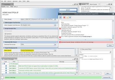

     I recently wrote in to report a problem I had with Quartus 23.2 Windows 11 and generating an HDMI IP example.  I installed Quartus 23.4 Windows 11 and I still cannot get an example to generate.  I get the errors attached and am using the settings also attached.  Any help would be appreciated.

At the moment, we do not observe any error during generating design example.
Allow me to clarify some items below first:
Q1. May I know which Windows operating version you are using?
Q2. Do you have multiple Quartus version install in the same operating system?

     I am using Windows 11 version 23H2.
     No, I only am using Quartus 23.4.
     I have over 50 GB of space.  I can generate other examples from different IP's, but not the display IP's.

I have found the same error as what you are experiencing.
After running some test, we found that this error occurs when selecting "Custom Development Kit" in the target development kit option in IP Parameter Editor in Quartus software.
ScreenshotScreenshot        Screenshot2Screenshot2
To workaround for this issue, you may generate the example design by selecting either "No Development Kit" or "Agilex 7 FPGA Development Kit"
in the target development kit option in IP Parameter Editor.
If you are using custom development kit, you can generate with above selection then you will need to re-assign the pin assignment in order for design example to work on you custom development board.
I have filed in this case to our internal team and they are running investigation on this.
This bug will be fixed in the future release of Intel® Quartus® software.

     Apologies for not responding sooner, I did not get a notification that I had a new answer.  It was a bug due to the board selected.  Thank you for letting me know.  I will fix it appropriately.  Glad that I found this.
