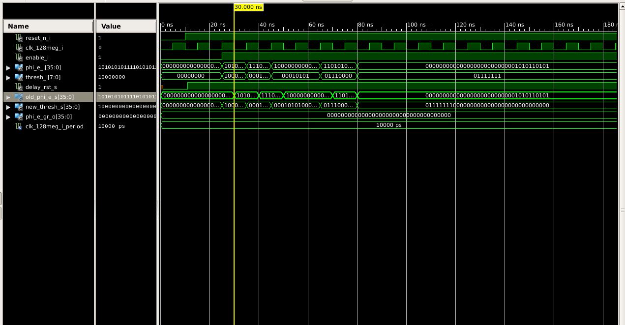

@tricky,
I have tried all possibilities and I find that the old_phi_e_s is not pushed to phi_e_gr_o as well as phi_e_i is not pushed to phi_e_gr_o. This is the waveform I obtain when I run the simulation.
https://www.alteraforum.com/forum/attachment.php?attachmentid=12710
Also I have changed my testbench because there was a kind of mistake in the design. This is my testbench code:
wait for 10 ns; reset_n_i <= '1'; wait for 15 ns; enable_i <= '1'; phi_e_i <= "101010101111010101101010101101010101"; thresh_i <= "10000000"; wait for 10 ns; phi_e_i <= "111010101101010101010101010101010101"; thresh_i <= "00010110"; wait for 10 ns; phi_e_i <= "100000000000000000010101010101010101"; thresh_i <= "00010101"; wait for 20 ns; phi_e_i <= "110101010101010101010101111110101010"; thresh_i <= "01110000"; wait for 15 ns; phi_e_i <= "000000000000000000000000001010110101"; thresh_i <= "01111111"; wait for 1 ms; reset_n_i <= '0'; wait for 1 ms; reset_n_i <= '1'; wait for 1 ms; enable_i <= '0'; wait for 1 ms; enable_i <= '1'; wait for 1 ms; assert False report "End simulation!" severity Failure; end process; delay_rst_s <= reset_n_i after 1 ns; new_thresh_s <= std_logic_vector(thresh_i & "0000000000000000000000000000"); p_check_outp: process(delay_rst_s, clk_128meg_i) begin if (delay_rst_s = '0') then old_phi_e_s <= (others => '0'); assert phi_e_gr_o = "000000000000000000000000000000000000" report "Output not set to default value when reset_n_i= 0" severity error; elsif (clk_128meg_i'event and clk_128meg_i = '0')then if (enable_i = '1') then old_phi_e_s <= phi_e_i; if (abs(signed(phi_e_i) - signed(old_phi_e_s)) >= to_integer(unsigned(new_thresh_s))) then assert phi_e_gr_o = old_phi_e_s report "Wrong output: phi_e_gr_o should be equal to old phi_e_i" severity error; elsif (abs(signed(phi_e_i) - signed(old_phi_e_s)) < to_integer(unsigned(new_thresh_s))) then assert phi_e_gr_o = phi_e_i report "Wrong output: phi_e_gr_o should be equal to phi_e_i" severity error; end if; else old_phi_e_s <= (others => '0'); assert phi_e_gr_o = "000000000000000000000000000000000000" report " Output not set to default value when enable_i= 0" severity error; end if; end if; end process;
Please help me to solve this issue. I am really fed up of why I am not getting the output
Altera_Forum
1,754 Views
This is debugging.
I have no knowledge of your deisgn and you are the best person to fix it.
Use the testbench and internal wave forms to trace a known input through the design, and ensure it is the correct values at all stages through the design.
