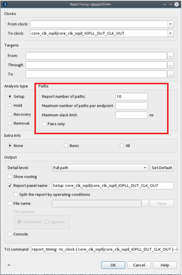

Thanks for the information. I tried
Reports>Timing Slack>Report Timing
in Timing Analyzer.
And it seems like we can probe only that nets that fail in timing.. Is this correct?
Nurina
1,732 Views
Nope. You can leave the maximum slack limit blank.
You can report all timing paths by putting 0 at "Report number of paths", however this can be time consuming because there could be hundreds and thousands of timing paths. I would just put a large number until it starts reporting positive slack. You can also sort the paths by slack in the timing report by clicking "Slack" on the panel.
