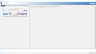

The "jtag_avalon_bridge:jtag_avalon_bridge_inst" is a QSys system instantiation (I am using Quartus 11.1). The "internal_stats" module inside the QSys system is the custom module I would like to debug.
As I mentioned the access through the NIOS is still not working. Any idea about what might it be wrong there? The address spaces are mutually exclusive and the "data_master" from the CPU is connected to the "tb_avs" of the "internal_stats". Despite this is a read-only interface I can also write to its memory space and the values I see are not as expected (I would expect almost all memory sections being zeroed).
For your reference have a look at the screenshot below:
What else might it be wrong?
These are the NIOS II core settings:
SFava1_1-1604301669322.pngSFava1_2-1604301689715.pngSFava1_3-1604301704667.pngSFava1_4-1604301774090.pngSFava1_5-1604301789939.pngSFava1_6-1604301803787.png
