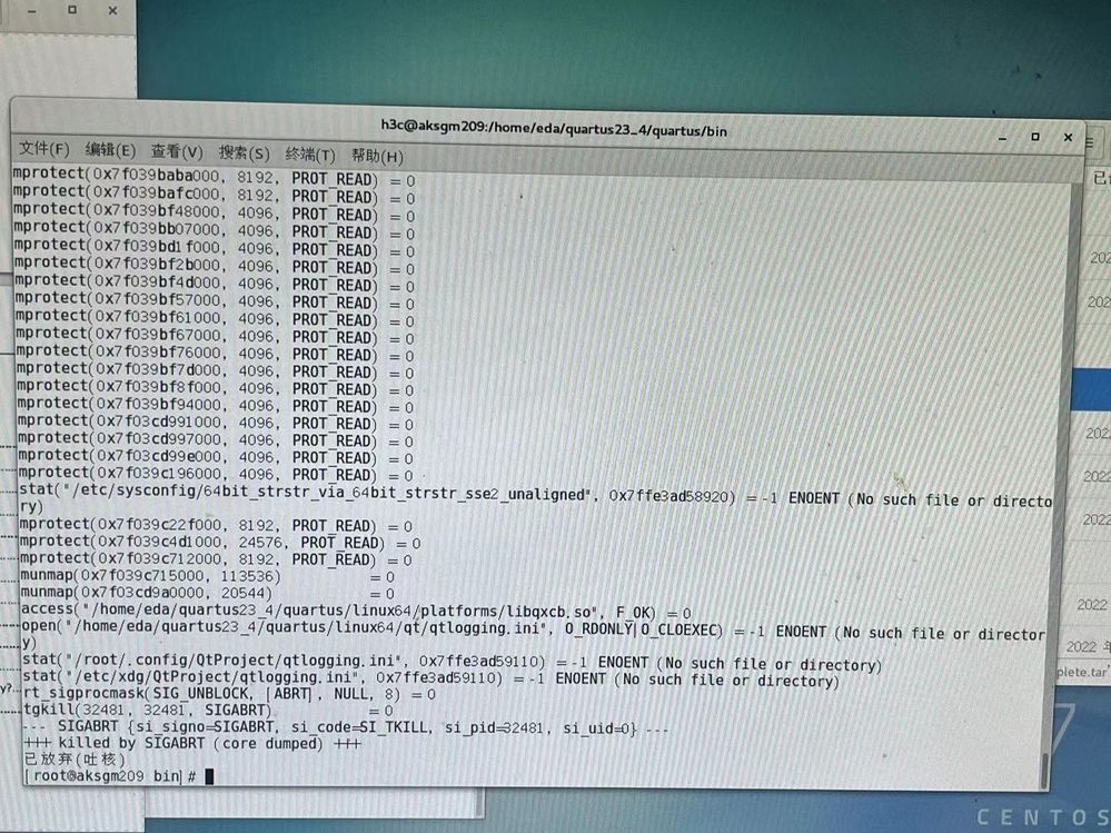

When I started using<quartz installation dir>/quartz/bin/quartz, the above error occurred. The operating system version is Centos7.4; QPP version is 23.4
How should I solve it? Is it a software version issue?

May I know which files in the quartus directory did you executed with? Also will it be possible to get the whole error logs for us to better understand the situation?
Just to add on for CentOS 7.4 it is not officially support, you may refer to the readme.txt files for recommended supported OS.

I believe you are trying to run the Quartus Software. Unfortunately, Quartus Pro 23.4 is not supported on Centos 7.4 OS.
Refer to the list of supported OS in table 3: https://www.intel.com/content/www/us/en/support/programmable/support-resources/design-software/os-support.html#editorialTableBlade-6
The last Quartus Pro version that supported in Centos system is version 22.2 and it is only supported specifically in Centos Linux 8.2, not 7.4.
Kindly use a machine with a supported OS to run the Quartus software.
