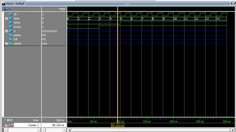

Hi everyone,
I am trying to build a LPF, an averaging filter in particular, so I used the FIFO MegaFunction, however, when I simulated the design in ModelSim it turned out that the FIFO is not accepting data and not spitting out neither. The output is stuck on 0 value (Check the screenshot). I tie up the 'read request' and 'write request' to one, so that it keep writing and reading on every clock edge.... is this correct? And of course, I added the 'altera_mf' library to ModelSim using this command:
vsim -L altera_mf -lib work testbench -t 1ps
And no errors on compilation. Any thoughts guys?

Just a quick note
you should not read from empty fifo, is your fifo protected neither write to full fifo- Als neu kennzeichnen

--- Quote Start --- I tried everything! With and without protection... keeping rdreq & wrreq stuck on 1 and swapping between them! Nothing works! Output is still zero. --- Quote End --- your diagram is not helpful. is it fifo output you are looking or somewhere further? isit zero or undefined? are yoiu writing to it?

No no... fifo output directly... and it is zero.
I am writing to it... but I don't know whether it is accepting or not. Thanks for bearing with me. ** UPDATE: I did a separate project contains only SCFIFO and simulated it. Results are disappointing again.. check screenshot in the main post please.- Als neu kennzeichnen

--- Quote Start --- Given your results, Im pretty sure your code is not error free. Why not post the code? Is this a standard Megawizard fifo? or some custom fifo? --- Quote End --- OK, here you go, I am using the standard MegaFunction... I bet that if I used a custom one I wouldn't have all these troubles! This is my wrapper module: ff is SCFIFO Megafunction.
module FIFO (aclr, clk, data, rdreq, wrreq, q);
input aclr;
input clk;
input data;
input rdreq;
input wrreq;
output q;
wire empty, full;
wire used;
fifo_mf ff (aclr, clk, data, rdreq, wrreq, empty, full, q, used);
endmodule
And here is my Testbench:
`timescale 1ns / 1ns
module tb();
reg aclr = 0;
reg clk = 0;
reg data = 0;
reg rdreq = 0;
reg wrreq = 0;
wire q;
FIFO DUT (aclr, clk, data, rdreq, wrreq, q);
always# 10 clk = ~clk;
always# 20 data = data + 1;
initial begin
# 40 aclr = 1;
# 10 wrreq = 1;
# 40 rdreq = 1;
end
endmodule
And just to disclaim any responsibility, here is my DO script:
vlib work
vlog +acc "tb.v"
vlog +acc "../FIFO.v"
vlog +acc "../fifo_mf.v"
vlog +acc "../fifo_mf_bb.v"
vsim -t 1ps -L altera_mf -lib work tb
view objects
view wave
log -r *
run 1 us
Now show me the error in my code.

I told you you have connected aclr to clk

--- Quote Start --- I told you you have connected aclr to clk --- Quote End --- Hhhhhh no I have not... the latter post is for a separate project. And this is how SCFIFO interface is organized! :) I am sure this is not the problem!

--- Quote Start --- Hhhhhh no I have not... the latter post is for a separate project. And this is how SCFIFO interface is organized! :) I am sure this is not the problem! --- Quote End --- latter post has conflict of fifo if with first code you posted. Anyway can you see fifo signals in sim (I mean fifo own ports) such as clk, words etc. fifos don't go wrong so it is either user error or library issues.

--- Quote Start --- Can you please try a simple simulation with verilog and send it to me? If you have some time of course. --- Quote End --- I did some work on fifo in verilog. If I changed your command to: vsim -t 1ps -L altera_mf_ver -lib work testbench then it worked (I used dc fifo with same clk connected to both clks but you can try your fifo) It is not project based so I can't send any files. Just instantiate dcfifo (I used quartus 14 64bit web edition) and wire it up.
