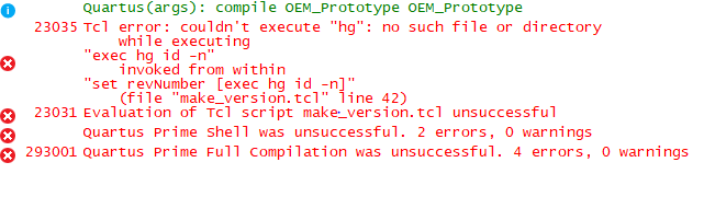

Hi Nigel,
Once I unzip and try to compile, I encountered such issue as below.
I am not able to reproduce this, therefore need your design with no error as below.
SyafieqS
4,995 Views
You can attached it here as well the zip/qar

May I know if there is any update from my previous reply?
I encountered and error related to quartus locating a script tcl file during unarchiving.
Can you reattach the design with previous issue solved?
NJackson
4,972 Views
I've reattached with design with the reference to the tcl file at compile time removed.
This should now compile for you.
