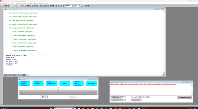

Hi All,
Just as part of investigating this MAX+PLUS II License, I have tried a short Verilog programme, and unfortunately the results are the same: "These Licenses pulled down from the "License Portal" seem NOT to work as shown in the attached. So, please, help, anybody !!!!!!!
Kind regards
Victor
FLEX 81500AQC240-2 was obsolete long time ago and no longer supported Quartus. No license is available for the device.
