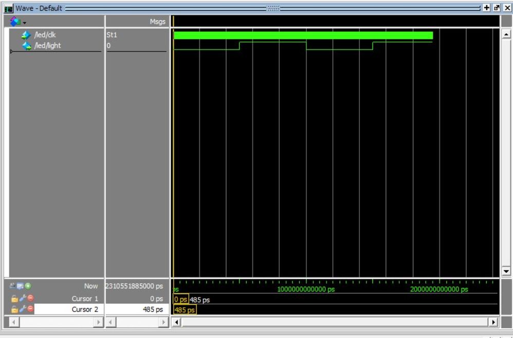

FPGA_user2
2,748 Views
Hello AqidAyman_Intel,
Sir, I am using a custom board.
For the statement: Can you help to measure the clock with the oscilloscope and verify if it is toggling?
Yes, I have checked the clock output in the oscilloscope; it's sinusoidal with a 50 MHz frequency. The IC number is U7. The oscilloscope used was 100MHz, 2GSa/s.
The RTL simulation is also run.
RTL simulationRTL simulation
Could we have a Teams meeting to discuss further about this issue?
Thank You
